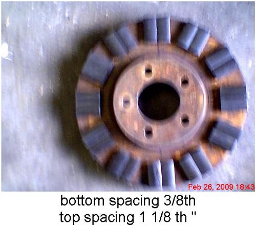

I have loads of questions. does any;one have sugestion? I build my first one. just charging 6 12volt marine batteries I got from a gem car I working on.

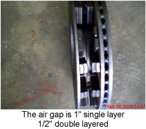

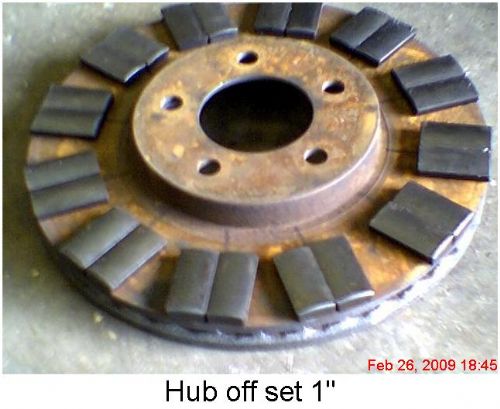

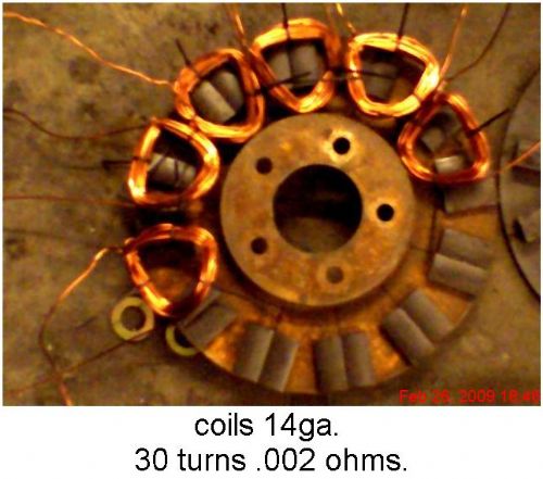

G'day mate, just a quick question, you have two rotor discs with magnets affixed to each in the first photo...where are your coils going?
It seems from the last photo, that you are using magnets as the core for each of your winding sets?

howde partner from georgia, usa. the stator will be laminated in epoxy and will be stationary between the two auto disc brake rotors. the air gap will be adjustable with shims between the hubs. I'm trying for 1/16 th air gap. the bearings on the hub are the size of big marbles. 1/2 inch dia.

I figured that may be case with a stationary disc in the middle. I think using what you have, will work...albeit not ideal but great for a DIY job using what you got
I would personally try and get another rotor disc shown on the left of your first photo...better for the magnetic flux to complete a circuit rather than have loss and more eddy currents occur relative to the air cooled one to the right.
Your air gap is dependent on what your end product will mechanically allow and also the amount of cogging you may experience. You mention an offset of 1 inch...so cogging is not an issue but phase timing will be.
I think you should determine alignment of opposing magnets on each of your two disks once you have the unit assembled and have them close to opposite as possible....just my thoughts

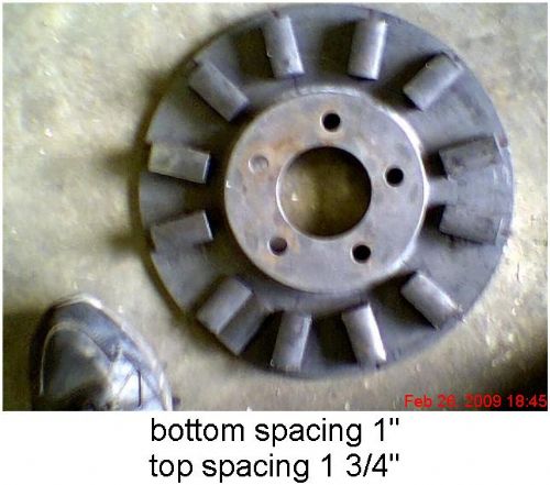

they are the same disc. I just cutoff the back side then turned it true smooth with a brake machine. man cuting that thing gave a new meaning to hard days work. it took about 3 hours. with a sawzall and metal blade then grinding then milling. but I guess I have to workout first. hay sofar I have 18 us dollars in it. including 12 batteries, copper mag wire 14 size. 50 foot tall 12 inch at base 4inch at top.. spun aln. light pole. 100 feet 4 guage 3 strand all weather wire. pvc watermain pipe 10 feet long 8in dia. 1/2in thick.1/4 steel plate to make mount for hub

Your magnets are curved on their face?
If so, have you determined polarity for N-S?Edited by CraziestOzzy 2009-03-01

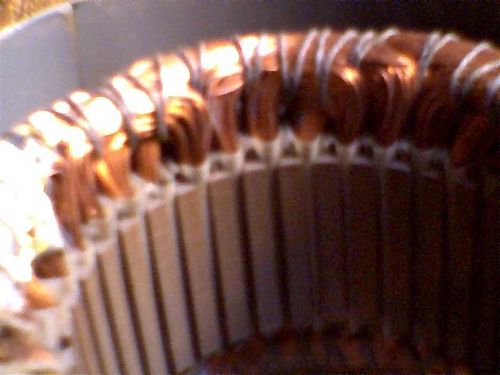

the next step is the form for the stator. scrape wood from the remodeling next door to me. if the rain would stop. do you think the windings are good enough. it all the man had at the time. I just got done unwinding a gas generator. found 8 lbs. of no. 17 ga. wire in it. hey 2 17's in hand equal 14 at the same no of turns.

OK, a couple of questions to answer yours,
How thick is the disk you machined on your first photo?
What type of magnets are you using (what are they taken from may help) and what are their dimensions?
Any chance you could confirm your magnets are curved on their face?
And finally, a quick diagram or sketch to show the proposed arrangement for your magnets on both disks, including polarity...I am a bit confused about your arrangement of magnets as each photo seems to be different.

the disk machined out to 3/16 thick no bleed thru from mags.
the mags are ceramic from ford starter motors. 2 inch long 1 inch wide 1/2 inch thick. slight curve on face. 1/32 off flat in center.faces are single polarity . I have not figured out which way to arrange mags yet double up or in pairs of 2nn and 2ss. for total of 12 on each rotor.

For the 12 pole magnet arrangement, you will need 9 coils arranged as 3phase with 3coils per phase.
I doubt that 30 turns per coil will be enough. You will need to confirm sufficient emf for the design rpm, and loading and rotor area. Do you have some idea of how big this mill will be?

               Just how strong are those ceramic mags ? If your going to want some decent power get rid of them and get some neo magnets. Over there in the US neo's are cheap. As your using 2x1x1/2 check these mags out.
               I'd hate to see you go thru all that work and find you have only a 100 watt genny at best. Also checkout otherpower and see how they did the disk brake gennies as that will give you all the pointers you need.

Unless someone beats me to it, I will run a quick simul on FEMM using your measurements, magnet specs and also take into account the metal composition of your brake rotor discs. Check this post in the morning
Your curvature on the pole faces may be a challenge for you later as far as getting air gaps right are concerned...might need a bit of machining to flatten crests which means doubling up the mags is a good idea. The suggestion of NEO'S is a great idea if you wish to spend a little money to compensate for your efforts.

  GWatPE said   For the 12 pole magnet arrangement, you will need 9 coils arranged as 3phase with 3coils per phase.
Gordon.
I did a FEMM test on the OP's arrangement and decided was worth while not putting the results up and agree with GWatPE :)
You will have to have more turns of that wire you have available to get something decent without spinning your proposed genny at the speed of light. You will need to settle for a smaller gauge wire using the current setup you have shown.
You also need to do some grinding work on those magnets you have as mentioned earlier too and make sure you are aware what is really involved with the circuit of magnetic flux. Your current arrangement produced a crazy amount of loss in the two backing plates holding your magnets and the amount of eddy current induced was ugly.
Keeping in mind you are using what you have available, I would suggest you figure out a suitable core/coil arrangement and number of poles (as mentioned by GWatPE), so that the magnetic flux does not bypass the centre winding of your coils.

thanks I found some 17 gauge wire for to old gas gen's that engine died on . I removed the wire. it 17 size. I have about 6 lbs. I may try and make some new coils. I think I can get 6o turns two in hand. I post picks when I get them made. what no. of turns do u suggest. I have more wire. possible 21,23,24 gauge. any suggestions.The magnets have a raised area of about 1/32 in in center> I was hopeing that auch a small high spot would not effect the field as much. these magnets can be found at any alternator/starter shop. they throw them away and don't rebuild them. I have unlimited supply. I would love to find a f&p motor here in ga. usa. but they are like finding a tasmaining devil in my back yard here ing the south . I have called every whrere. and I have a scrape yard owner Keeping a eye out for them. I also have some collectoin center in the counties keeping a eye out.

I would shy away from the 2 inhand 17 idea.Maybe 300 turns of #24 with iron filings or powder has a core for the coils.Those mags need all the help they can get.Then just go the standard 12/9.
I still think they would work better for a motor conversion.The steel is right there then.No gap to jump.One could even give em a slight skew with grinding wheel since heats not a factor unlike the neo.
