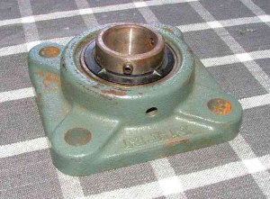

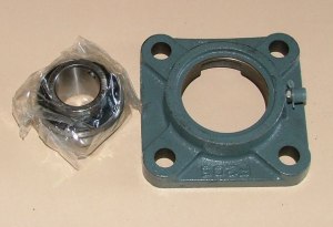

I agree with Gordon the standard F&P bearing is not the best option for long reliable duty.
I've used the 56205 double row bearing and its matching carrier F205 for a few projects now, its a tough little bugger and matches the F&P shaft.
