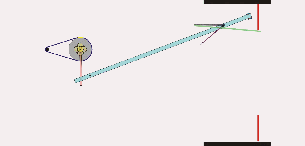

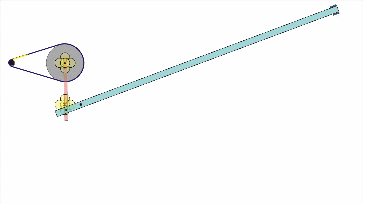

hi there guys,
John check it out i managed to show the mechanizim on how it is supposed to fly...i gusse...
the question is,..is it worth building just for fun?!?!
what do you think?
regards
Many Ideas One Brain.
http://www.wrapwind.com

Hi faroun,
This is not as I imagined, but would probably still work. You may be able to use magnets as latching devices to hold the vane during the power strokes, a bit like cupboard door latches. Automatic furling if the wind is too strong with the magnets unable to hold the vane. Gravity would come into play and return the unit to the bottom of the cycle and reset the action.
I cannot see this being more than a talking point though.
Gordon.

Looks like fun, you may power a few leds... well .... maybe, but a talking point for sure.

True. But your frontdoor isn't connected to a generator and being loaded. The frontdoor behaves more like an unloaded windturbine in a runaway situation. It's important to distinguish between energy and power.
To the OP: Don't want to sound too harsh and rain on your parade, but this entire contraption looks silly and overcomplicated to me. I count 6 pivot points/bearings, and a belt. Not sure why you are wanting to convert linear motion into rotary motion, when it'd be much simpler to start with rotary motion in the first place. I expect it'll be noisy too, as the flap moves over twice each cycle. The repeated up and down acceleration will be hard on the mechanism as well (think 'reciprocating engine' vs. 'gasturbine').
But if you really believe in this idea then definitely go for it and build one, then report back here. Should make for an interesting story once it's finished and working.

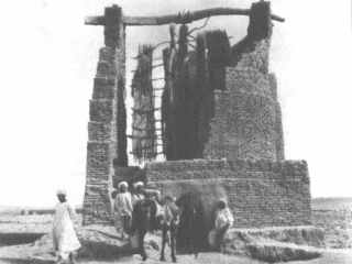

Peter, if I am not mistaken the first recorded example of a windmill was a revolving door contraption used to grind grain in ancient Afghanistan.
Dinges

[quote=KiwiJohn]if I am not mistaken the first recorded example of a windmill was a revolving door contraption used to grind grain in ancient Afghanistan.[/quote]
True KiwiJohn. But we have evolved a bit since then...
Edit: ...and notice how even those people started with rotary motion in the first place, not linear motion...Edited by Dinges 2009-02-07

Peter, I have been to Afghanistan and I could not say for sure if that is an old picture or one that reflect current practice!
However, as far as I can tell such devices are drag machines and as far as total power goes very inefficient. As you will doubtless know efficiency and effectiveness are not quite the same thing and a big revolving door, or flapping wing, system might generate about the same power whatever the wind speed?
I guess the flapping wing could be made more efficient with a suitable aerofoil section.
Your comments regarding complexity are valid but in the case of the water pumper I saw described it was not so complex at all as the arm acted directly on the pump rod.

Converting linear motion into rotary motion (or reverse) isn't very hard to do normally. It was used in reciprocating steamengines as well. However, in that case the linear motion is longitudinal, whereas in Faroun's case it's transversal. And that case is a bit harder, requiring an extra linkage...
As to the efficiency... I was wondering how much mechanical power the VAWT pictured above could generate, and how it would compare to a modern HAWT. An inefficient contraption can still be very effective though. I bet that mill was pretty good at milling grain.Edited by Dinges 2009-02-07
