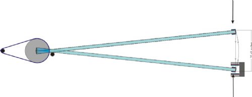

here is a quick rendering to show to objective.
Many Ideas One Brain.
