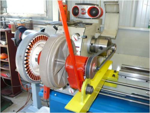

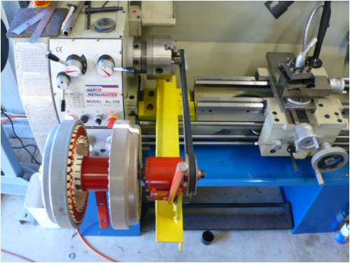

Posted: 11:46am 18 Dec 2008
Hi All ,
Finnished the test rig for testing , I have taken Gordons and Herbs advise and built it so the torque arm between the dual stators can be rigged with a spring scale or I was thinking of a set of digital kitchen scales and a roller bearing on the end to push on the scales , I have drilled a couple of holes in the arm to allow the arm extension to go on later as I am not sure what length to have it .
The reduction of the lathe is 1.6:1 and I have a larger pulley to use that will probably be 2.8:1 so I should be able to cover a fair range of speeds below 400rpm .
Hopefully as stated , with the mesurement of the torque , the tests will not be masked by other variables ...
As you can see I have used one of my dual bearing housing to allow the whole dual stator to be floating , of course the test does not have to be a dual as one stator can be removed . I was running it today at no load , no declogging and the small 200g scales I have were reading 170g @ 40rpm , as I do not know the caculations for the HP or watts at a certain length I will leave that to be informed of through the forum as I am sure someone will know and will be able to give a standard torque arm length .. Regards ..
GWatPE
Joined: 01/09/2006
Posts: 2127
Posted: 12:22pm 18 Dec 2008
Hi Phill,
you have been spending too much time at Bruces. Too clean for me and all that fresh paint. Only kidding!
Great job.
Need a cheap source of caps now, for a decent range of testing combinations. May be useful to confirm some predictions first though.
Gordon.

Phil, I believe torque is length of the arm times the 'weight' you measure. Horsepower is torque times RPM. Horsepower is directly convertable to Watts. Without the length of the arm I cant calculate anything interesting from your 40rpm example.
I suggest if you want to use heavy weight scales you would choose a short lever length, but if you have the room and want to make the calculations easy a lever of 1 metre would be a good choice. I think if you want accuracy you would have to balance the stator assembly so that at 0rpm the scales reads "0".
If suitable scales is a problem I suppose you could use a long arm with a sliding weight on it but you would have to run the lathe in reverse (I think) and you would need to put limits on the arm so as to avoid accidents.
Nice looking test rig. Edited by KiwiJohn 2008-12-20
herbnz
Joined: 18/02/2007
Posts: 258
Posted: 11:22pm 18 Dec 2008
Phil
Great setup
Ok Torque is Force (Kg ) * length to the attachment point scales from shaft centre (metres ) * 9.81
this is Newton Metres
The scales must act a right angle to the effective arm to the shaft centre.
Power in = 2 * pi (3.142) *N (rpm ) * T ( Newton metres from above) / 60
This gives Input in watts
Hope this makes sense
Herb
Ps
If I assume your arm is 150mm
Torque = .17 *.15 * 9.81 = .252
Watts = 2 *3.142 * 40 * .252 / 60 = 1.05 watts Edited by herbnz 2008-12-20
