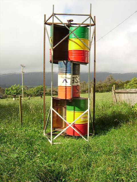

Posted: 06:16am 06 Dec 2008
A quick snap

Russell,
I like your choice of 3 offset savonious rotors. Framing is certainly not overdone.
There's a common problem with VAWTS in the real world, by the time they get big enough to do some real power generation, they are too big to put up at a height where they can catch the wind.
Mind you this mob did all right with their 4 stacker Here.
I like the multi colour effect. When you give it a paint job I'd keep it similar.
Keep up the good work.
