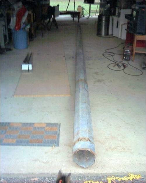

The guyed tower consists of an 8m octagonal pole as used for street lights with a 6.5m length of 3" water pipe ontop of that and then around 3m of 2.5" water pipe at the top giving a total of 17.5m.
This is the base of the tower after rewelding it back together as it was found in two halves.

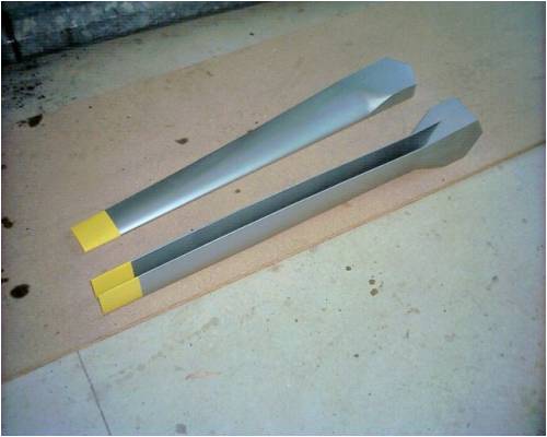

These blades are carved from laminations of 18mm plywood as per Hugh's instructions although I measured them today at only 1150mm long so the dia is 2.3m. They were then given kevlar leading edgesand carbon on the MAC and coated with woven cloth and epoxy resin. The finish is 2 pack paint.

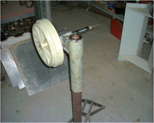

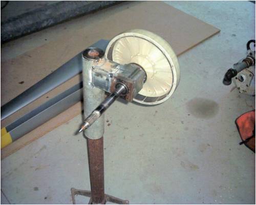

This is were I am up to with the head of the machine. It's based on a 60 series F&P which is wired for 2 pole star or delta. I wish I hadn't rewired it now as I think I am going to have trouble getting the voltage I need.
I still have to sort out the furling system. I had an idea to make a spline for the prop drive. I'll drill a series of 20 holes, 2.5mm dia on a 19.5mm PCD into a piece of 50mm bar. Then machine the centre out to 19.5mm which should leave me with a spline which should provide enough drive for the F&P system. Then weld the 50mm bar to the prop back plate and away I go. The dimensions might need tweaking but I'll double check that before I start machining.
