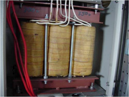

The AWP (African Wind Power) 3.6m has a single three phase transformer that looks like this (in fact is this)
It is nominally 350v input. You can use three single phase transformers instead of a dedicated one.
At 240v input it puts out around the 55v mark up to 30 amps. The mill runs around the 240v range, but unloaded goes 600+

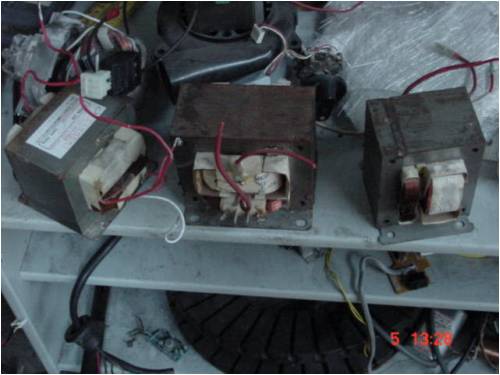

Rewinding ones from microwaves is a simple and dirt cheap way of getting the tranny's. It is most helpful to split the laminates completely and lacquer them if you want good efficiency. They are designed as a ferro-resonant transformer, so they don't care too much about core losses as they drive them deep into saturation anyway. You don't want to do that or you waste too much as heat.
Even the primaries are probably only really 160v even though they run 240.... that's how they saturate them, but a 160v 50hz primary may be ok for the f@p as the freq is probably higher when you get going. The AWP is only 30 poles so it's freq range is lower.

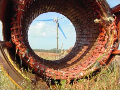

Do you mean something like this? (only weighs a ton or so)
I've seen Rons little stator. It is slightly bigger than the AWP stator. Same design.
.........oztulesEdited by oztules 2008-11-28

I hadn't thought about that 500kW genny of yours yet... I count 60 stator teeth. So a 20 pole generator would be an option.
Peter walks off to find his calculator... wonders how many 2x1x.5" magnets it would take... and what size blade...
