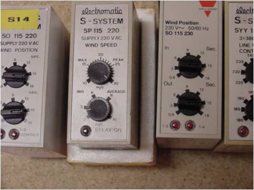

These things form the backbones of the two bigger mills down here.
I am currently rebuilding these ones which are faulty..... they have their problems I'm afraid.

You're beginning to give me an inferiority complex here... Every time I have this brilliant new idea you pop in and say 'been there, done that, and now I'm repairing it'.
  Oztules said   they have their problems I'm afraid.
Anyway, if someday you decide to do a write-up of the problems of those two installations and how you solved them and/or repaired those particular control modules, you'd have at least one attentive reader.
