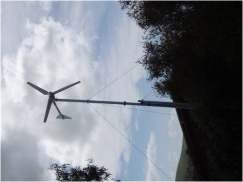

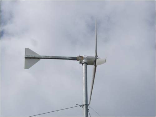

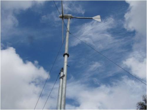

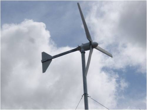

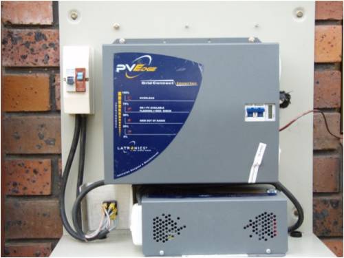

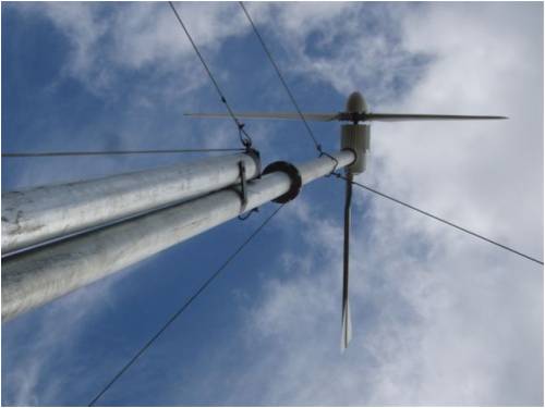

Bolty
Joined: 03/04/2008
Posts: 81
Posted: 01:08am 13 Oct 2008
The turbine is a nominal 48 volt which matches the PVE 1200 very well. The controller is the recently released Latronics TC48. This couples well with the PVE and applies PWM braking at 75 volts, which is very close to the turbine producing the inverter power limit of 1200 watts. So far I have been very pleased with the controller. It has a large inbuilt bank of capacitors of 0.1 Farad. This has the effect of keeping the system ready and it seems to be able to hold the inverter synchronized to the grid for up to 15 mins, without the turbine generating the necessary 55 volts to input power. I have observed no wind activity for 10 mins, then a wind gust feeds to the inverter immediately. The $2238 cost for the inverter included the controller and the Latronics weatherproof box.
I have downloaded some pictures that hopefully come through OK!
Cheers!
Bolty

does the 3phase from the turbine get rectified at the LATRONICS box or on the turbine? how long is the cable?

The 3 phase bridge rectifier is in the Latronics box, and should be able to be seen in the photo at the bottom left, below the circuit breakers that act as a brake. The cable came with the system, and is about 4mm2 copper. It is about 10 metres long, and I have not yet cut it the shortest possible length (to minimize losses)
