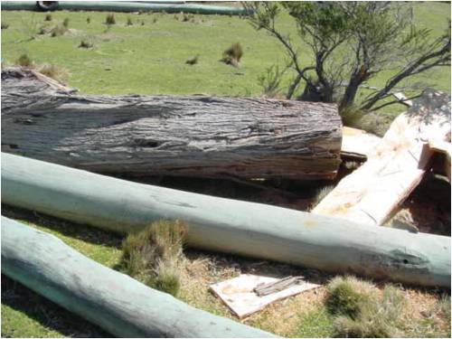

So we selected a decent sized Macracarpa log which looks like this:

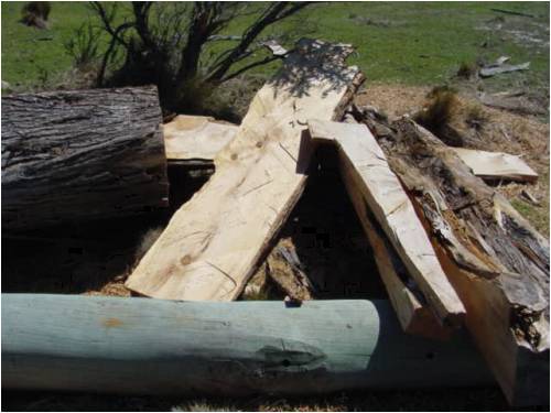

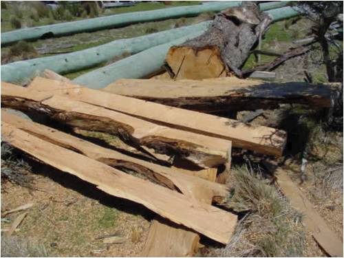

We hacked into it with Jamies 28" chainsaw and fashioned some very very rough planks,and lots of offcuts too:
You can see an offcut slab left behind as well as these offcuts:

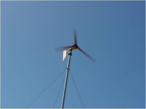

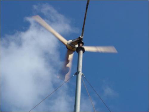

But here they are flying again, I went back up there today to take pics of them, So now we have fixed the injector pump on the Lister, and built , balanced and installed the blades...... of course the sun is shining brilliantly and the solar is putting out 1KW instead of a few hundered watts, the mill steadily putting out another KW. or more..... and the dump load working overtime again...... sigh.... it never rains but it pours.
(and more happy neighbours too)
