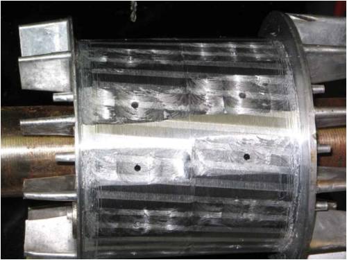

A few more machining steps involved milling the flat faces. You can see that there are two rings of flats destined for two rings of magnets. The offset of the faces will provide an anti-cog skew. As the magnets in each ring are attracted clockwise to the teeth of the stator, the magnets on the other ring will be attracted to counter-clockwise teeth on the stator. That's the theory, and test fitting of the rotor bears that out. (more on that later).
Each of the mounting holes are tapped. The holes fit 6-32 NC screws. Obviously one uses stainless steel screws for this job. Steel ones would reduce the strength of the magnets. I had tapped 21 of the 24 holes when I broke the tap in the hole! There was a tiny nub sticking out, which I could grab with the pliers to slowly work the end of the tap out of the hole!
That broken tap on the 21st hole was, it turns out, a warning of more trouble to come.

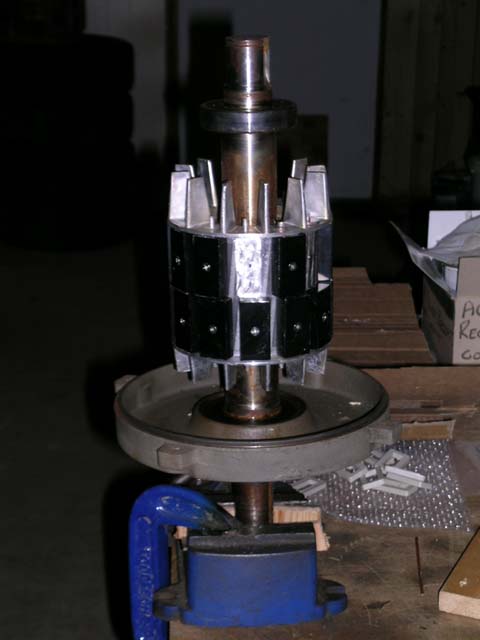

Before going too far with the magnets, I put on just four, and put it into the stator to get a "feel" for the de-cogging skew's effect. The rotor turned smoothly, but with a fair bit of resistance. It is called "iron loss", meaning the magnetic field dragging through the iron of the stator requires some force to be overcome. I hope the resistance doesn't scale up by a factor of 6 when I get all 24 magnets on. That could cause a big problem with start-up torque. Anyway, there wasn't much cogging so I satisfied myself with that result, and continued installing magnets.
I got to the 20th magnet. The 21st magnet WILL NOT GO ON.
It took a lot of force, luck, and several tries each to get magnets 12-20 mounted.
Previous projects that I have studied on the internet forums, either by zubbly, dinges, or other distinguished experimenters, where many magnets were installed on a single rotor, have all employed rotors made from scratch. I thought I was lucky, having found a rotor where I could use the original laminations and cooling fins! Argghh!
Installing magnets on a rotor without cooling fins is comparatively easy. I did that myself on my first motor conversion. You position the end of the magnet on the edge of the rotor flat, and slide it on. It takes some marshalling because the magnet does want to slide around a bit, but it's not that difficult, especially if you can screw each one down once it's in position.
With cooling fins, you either have to tip it up, beside it's neighbours, or push it down flat. All it wants to do, however, is flip over!
If I can find no way to install the remaining four magnets, I will have to disassemble the entire thing and go back to the shop to remove the cooling fins.
I am currently building a tool to force the magnet to remain straight as I force it into place. It's slow going, but I'll let you all know in a few days what does, or doesn't work.

Sparweb,
Try a high tensile rod the size of the magnet/screw holes (maybe 4" long...a skinny philips driver perhaps). Place the rod through the magnet hole and align the rod into the rotor hole.... and push the magnet down the rod until it beds...
The most the magnet can do then is spin on the rod... which you will control, and later will be stopped to a fair extent when you get it below the end rim....clamp it, remove the rod and screw it down..... sounds simple if you say it quickly........ (may need someone to hold the rod/screwdriver while you clamp it and finish the alignment).

Struggling with these magnets for hours has made me believe that mounting the magnets, say, as a 12-pole rotor, would be much easier. Mutual repulsion as I push these down is stronger because I am trying to push a N magnet pole between two other N magnet poles.
Weighing the work (and potential danger to fingers) of wrestling these magents around against the time required to re-wind one of these things (to increase the pole count) and I'm starting to see another reason to like what Peter did with his 10HP.
Cranking a magnet down on a 6-32 threaded rod might work, but it may be too flexible. Thanks for the suggestion. I will try that. Probably didn't consider it before, because it would require two people to make it work. Convincing my wife to help hold on to things may be trickier than manipulating the magnets themselves!

It worked! I bent one 6-32 rod because I was too impatient to wait for my wife to finish chores and help. Once she was there to crank the nut down as I held the magnet in alignment, things went pretty well. Several magnets are really scuffed up, but the job is done and maybe something like this can be painted.
In all the fiddling around, I have now magnetized three screwdrivers, a c-clamp, a pipe clamp, a wrench, several lengths of threaded rod, one pair of pliers, and a pair of wire cutters!

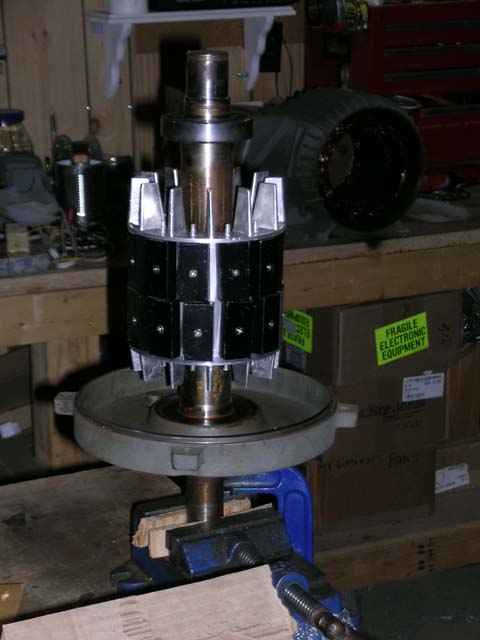

The rotor on my bench is complete, but there still seems to be some stray field lines because I can pick up washers and screws with the end of the shaft, now. The rotor may not be keeping the lines inside the laminations, or it may have something to do with putting 4 inches of magnet on a stack of laminations only 3.8" across.
