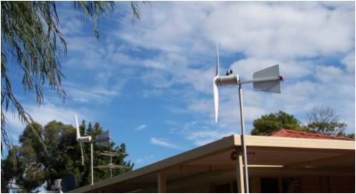

Hi Marcus - Looking at your picture it is the same motor. The problem I am having is being able to get enough power from the wind to turn the shaft under load. I guess I will have to work out the correct gear ratio to do this, 4-1 ratio wasn't enough. I don't know much at all regarding the electronic side of it, if I can put a prop on it and it lights up a few lights I'm happy,lol.
The pic is of a couple of small gen I have made using printer motors which are 24 volt and put out around 5 volts.
