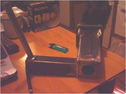

I am making a F&P windmill,following the instructions on this great web site.
BUT, i havent followed to well and have but the holes in the 40x 40mm square tube in the wrong place,and now the 40x40 fits on the othe side of the unit.Will it make any differance to furling of the mill?? Please HELP.

It will be fine. You havn't welded on the mast tube bit yet, so it will go to the left of the main 50mm box section ( where you lighter is ). What you have made is a mirror of the original design, and it will work perfectly well. It just means it will furl in the other direction.
