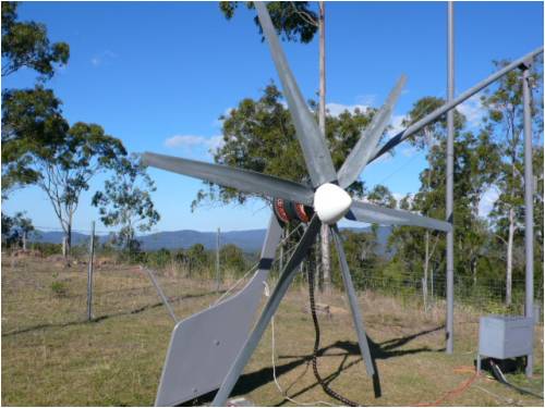

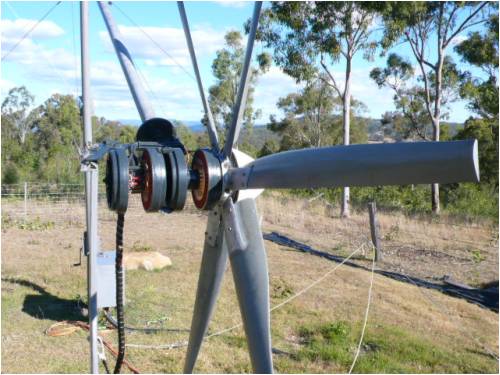

Hi all ,
Decided to throw on 3 more blades to the Quad as the wind has been light of late , the three blade @ 3.2mt dia driving the 4 stators has been performing better than I thought but needs 10 to 12 klm to keep it spinning and cut in at 12.5 klm @ 104 rpm with all stators in delta , with the 6 blades I have changed one 80S & one 60S to star dropping the cut speed . This will now give a different cut in for each stator , 60S star @ 64 rpm , 80s star @ 84rpm , 60s delta @ 104rpm , 80s delta @ 143rpm which is basicly the same in principle as the staggered stator rewire that Glenn was experimenting with but using 4 unmodified stators instead and hopefully will keep a gradual load on the blades as the wind power increases and not cause stall out..
The 3 extra blades are the first set I built and are smaller @ 2.7 dia and cut different to the 3.2 set but they are all in balance and should be OK for the test period , with the wind mostly below 12k it easily starts in 7 to 8klm and keeps spinning in 5 to 6 and at 100 rpm in 11 to 12 klm was turning 70 watts instead of just starting to cut in with the 3 blade , anyway looks a bit prommising for low wind performance so far ..
I am about to start building my second gen as I have just bought a good lathe so a lot of things that have been bouncing arround in my head can be built and trialled , anyway here's a couple of pic's
Will hopfully have more data to post later in the week ...

Holly cow batman, I thought the last one was big!
I think you'll find the 6 blades work better with the staggered stators. More torque at low speed, though you'll loose a bit in high winds. I've been happy with my 6 blade dual stator, it just makes power every day.
You'll have to post a picture of it up in the air.

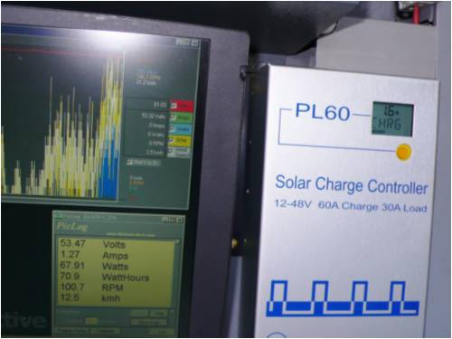

As promised some more pic's , yesterday with virtually no decent wind but a few puffs after 2pm and fluctuating from 8 to 14 klm it produced 70 watt hrs , the 3 blade would have been lucky to do 10 .. The shot of the piclog shows the graph almost with constant blue under the white which is wind speed .

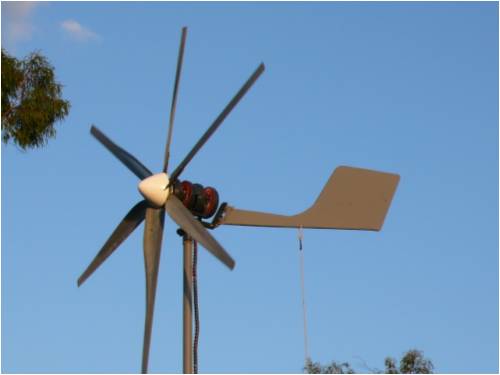

Up in the air

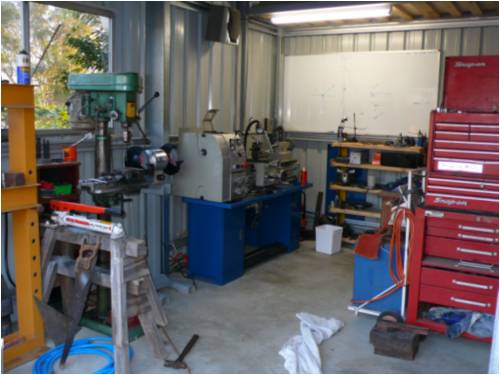

Great looking work on that mill, my only quibble is that you keep your shed far too tidy.
