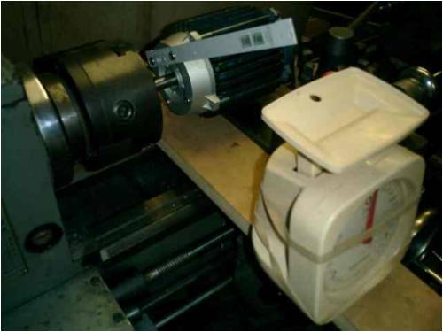

All this talk lately of efficiency made me curious as to how efficient my 500W motorconversion 'blue boy' actually is. I decided to measure it. For completeness' sake I'll include all measurement steps so others can easily repeat it for their generator if they desire to do so. The 'math' part below can be skipped if you're only interested in the results.
To determine generator efficiency we need to know both the mechanical input power and the electrical output power. Electrical power is easy to measure using a voltmeter and amp-meter as the genny is charging the battery.
Mechanical power isn't much harder to determine using a De Prony brake. Below is a photo of the setup I used.
The lathe was used to supply mechanical input power to the conversion. The generator shaft is clamped in the chuck. The house is more or less free to rotate but actual amount of rotation is held in check by an arm (with measured length l). The end of the arm presses against a weighing scale. The 'weight' on the scale is an indication of torque, which can be used to determine mechanical input power, with the exact relationship being:

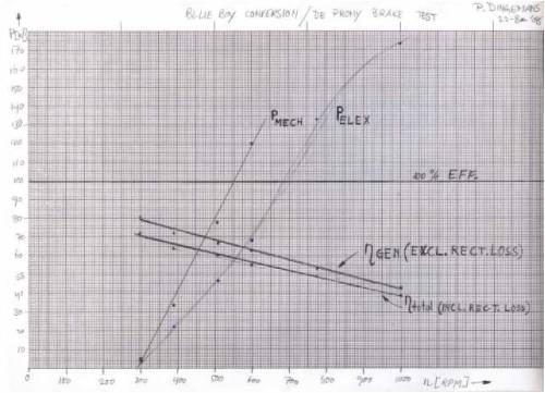

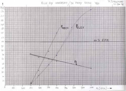

Below is the graph that shows both mechanical input power and electrical output power as a function of RPM, with power (W) being on the left scale. The downsloping curve is the efficiency curve, with the horizontal line being defined as 100% efficiency (chosen so that 100W on the left equals 100%)
(high-resolution images can be found here:
http://picasaweb.google.com/motorconversion/500WMotorconvers ionBlueBoy (click on the magnifying glass to zoom in))
To my surprize, efficiency in the lower output range was actually quite high; at 3.8W electrical power into the battery efficiency was 72%. This figure takes into account ALL losses in the system, also rectifier losses, so the actual efficiency of just the generator would be even slightly higher. As output power goes up efficiency goes down, as expected because of I^2*R copper losses. I rate this generator at about 100W maximum (even though it originally was a 500W motor). At full rated output power efficiency is about 50%, which isn't fantastic in my opinion.
The losses consist of all losses in the conversion chain: bearing losses, iron losses in the stator, copper losses in the stator, wire losses to the battery and rectification losses in the 3-phase rectifier. So it includes more than just the generator losses. Power lost in the rectifier is about P = sqrt (3) * 1.5V * I so definitely not negligeable. As there may be non-linear losses involved (losses that vary non-linearly with RPM) I decided not to calculate 'the' efficiency but rather establish an efficiency curve over the operating range of speeds.
One more note; after the testruns the generator was noticeably warmer, I estimate it was at about 45 deg. C. So was the rectifier. Of course, the power losses had to go *somewhere*, in this case being used to heat the generator, rectifier and connecting wires. At some point there was 470W being put into the genny and 176W extracted, so the difference (~300W) had to go somewhere...
All in all this is a pretty simple measurement technique to determine generator efficiency, which yields a lot of information about the performance of the generator. It would be nice to see more of this kind of data in the future from other people's gennies, as it provides a yard stick to help evaluate performance of generators.

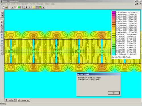

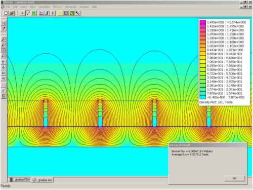

I did not use a lathe to spin my alternator. I used one winding. I had a pair of hall effect rotor positioning sensors. These controlled an electronic switch that pulsed current into the coil at the correct timing. This was connected to a DC power supply with RMS voltage and current sensing. One of the other windings had a resistive load applied. The RMS voltage developed across this resistor was measured and confirmed with a CRO. There were two unused windings in my case. I measured power in and power out at various input voltages. The fixed pulsewidth gave a varying rotor speed with input voltage. The efficiency was close to unity. This was 15years ago when attempting to get over unity was the go. The resistance of the load was over 100x the windings resistance.
I do not intend to repeat this exercise, but others with ironless axial flux alternators may be able to reduce the air gap and modify the coil shape for square waves and confirm on a setup like yours.
I remember performing electrical efficiency testing of all sorts of motors in an electrical engineering module at Uni. All these systems had an iron core, including DC, AC induction and AC synchronous all had efficiencies below 90%. The AC synchronous was about Max. 88%, the DC about Max. 85% and the AC induction was about Max. 70%. This was at about the 500W power level. This was over 30years ago, but the engineering hasn't changed much.
This was why I explored permanent magnet ironless designs in my research.

I did make a graph of the generator efficiency, this time excluding rectifier losses. Rectifier losses *do* matter in the entire windgenerating system, but shouldn't be included in the generator losses, so I separated the two now.
(high resolution image here:
http://picasaweb.google.com/motorconversion/500WMotorconvers ionBlueBoy/photo#5237671013160885154 )
As can be seen, maximum generator efficiency is about 80% at the lower range, decreasing to about 60% at its rated 100W output power. Most of the loss is copper loss, with rectifier loss and iron loss being of lesser importance: at 1000 RPM there was about 46W iron loss (10% of 468W mechanical input power), 16W rectifier losses and 210 W copper losses).
I'm pleasantly surprized by the generator efficiency at the lower end of the power range, I would have expected it to be worse. 70%-80% I consider to be acceptable for a motorconversion. But the fact that the iron losses are so low compared to the copper losses suggests this generator is 'undermagnetized', despite my attempts to cram as much magnet as possible in there. Most likely it's caused by the relatively large airgap. This was a deliberate design consideration but, as can be seen, comes at a price: acceptable efficiency in the lower power range but rapidly increasing copper losses as power goes up.
Edited by Dinges 2008-08-24

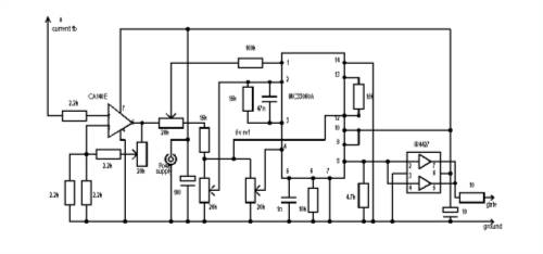

Ok, that one by flux looks to be a perfect candidate for that size project you have there.

I would say that the power to be dissipated would quickly raise the temperature of the machine to a level where there could be permanent damage to the permanent magnets..
You might be interested that the wire in my machine is 0.18sqmm and each winding has a resistance of 0.8ohms. Each winding passes a max 4A and there are 4 windings. My machine dissipates a measured 65W in the stator at the 450W maximum power level. This equates to only 87% efficiency. The efficiency increases to 93% at the 100W level, a level where the mill spends a lot of time. I have to accept an additional 13W loss as well in the schottky diode rectifier at 450W. The maximiser adds an extra 6W loss at the 100W level and 9W at the 200W level. Maximum losses are at maximum power. System efficiency is maximum at 24W, but I consider this relatively unimportant.

edit
Didn't come out too well here...
If I get time I will draw it out better for you

Hi dinges,
this was not for a windmill, but for a brushless DC motor for a solar car application.
I challenge the mechanical robustness of an axial flux design machine you mention.
My axial flux altenator has a closed external construction. The rotor is supported on 90mm OD bearings each end. The stationery inner shaft bearing dia is 65mm.
The designs provided by DanB and Piggot etc are simplistic, but considering where they were intended to be made and used, they are doable.
I hope to publish more photos of my setup.

Thanks Oztules. The schematic looks familiar (I've seen it before) but is unfortunately illegible. And I don't see any inductors or capacitors that function as charge storage for the boosting, or any big transistors/FETs ?

Dinges, go to Flux's files, it looks better there. So you should recognise it.
Flux's stuff in Gordons Maximiser thread
6th reply down.
The fet and the coil is pretty experimental from Flux's description. In your case you could probably use the motor as the coil as Flux described in his load matching article. The fet is after the driver chip.... whatever will match your device.

Thanks Oz, I found the picture but it's moderately useful without the comments. Here's the full story by Flux:
http://www.fieldlines.com/story/2006/4/24/92132/1267
Will read it ASAP.
