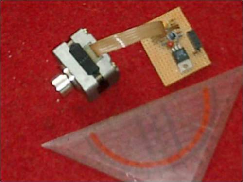

Now that your power requirements are so much smaller than initially stated (2.8W vs. 20W) you may actually get by with a stepper motor (can be found in 5 1/4" floppy drives, old printers, scanners, etc.)
These easily put out 40V+ just by handspinning them, but their current is very limited, maybe just 100mA or so. If they don't produce enough power you could even install 2 or more per turbine.
The advantages: cheap(free if you know where to look), easy to acquire, easy to use (no DIY genny building needed). Power is very limited but 2-3 W may be doable. I've built a tiny genny too like that once (handcranked) and it lit up white LEDs just fine:

  mystiquesbs said  Just wondering how do I measure the voltage from these? They have 4 wires and I'm only used to the DC motors with 2.
Heh. Just don't do as I did the first time and hold the wires to your tongue while you give the shaft a quick turn. Nearly bit my tongue off at the time...
Didn't you see this page by Gizmo in the link I gave you ?
http://www.thebackshed.com/windmill/assemblyMini3.asp
A 4-leaded stepper is shown at the top of the page. Find out with a multimeter which wires belong together (are connected to eachother), then connect a DMM to them, set to measuring AC voltage and turn the shaft. Next, you could also try setting the DMM to AC current and measure short-circuit current.
Build a simple rectifier as shown in Gizmo's article, measure output voltage at your desired RPM (depends on your actual windturbine) and wire it to a string of LEDs with series resistor to limit current through the LEDs. The number of LEDs you can put in series depends on the maximum voltage of the stepper under load at the desired RPM. You'd need to experiment a little and play around to find out what works best.
