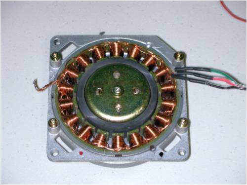

Okay.. I'll give you all the information you want.. Here is the picture of the motor before any modification:
This thing came out of an old DLT tape backup drive. Actually, I got two identical ones out of the drive. The size of the motor is about 3.5 inches diameter and about 0.75 inches thick.
yes, I am aware this won't produce an enormous amount of power. What I'm wanting to do is build a small wind generator first (maybe 4 feet in diameter) as a learning experience and so that I can experiment with different types of blades and fabrication techniques. Once I'm satisfied, I'll move on to building a much larger one.
I have taken the motor apart and I have started to unwind it keeping track of how it is wound. I was actually surprised to learn how it was wound. There are 32-turns on each pole. It doesn't really make sense to me. It has 18 poles and I would have always imagined that the 3-phase system would have been wound like 1-2-3-1-2-3-1-2-3, etc.. But it is actually like this:
They aren't spaced exactly even which I thought they would be. Would there be any advantage to re-winding them 1-2-3-1-2-3, etc?
I found some magnet wire at Radioshack yesterday evening but the spool was so small I don't think it is long enough to give me 320 turns per pole. I'll need to buy a spool from the internet.
So anyway, I plan to wind this thing back up in whatever arraingment makes it best suited for generating electricity for charging a 12V battery (so around 15V to 16V, I would think)
As for the person who said this motor isn't suitable. Well, I think the size is perfect, and the re-winding will be a learning experience for me which is what I wanted. So I think it is a suitable choice. I just need to figure out what I'm doing.

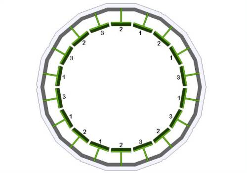

Under the "things you learn" category, I too would have thought a 3 phase set up would have the coils in a 1-2-3 pattern. Seems intuitive .... but apparently not!
There is a recognizable pattern in the 18 coils tho. 18 coils/3 phases means 6 coils per phase. The 6 are split into 2 sets of 3, which are diametrically opposed, and the middle coil is wound opposite in every set.
That makes me feel better somehow! LOL!
How the timing could possibly work with 8 or 10 poles, or 42 for that matter, makes no sense to me at all, but I'll keep lurking along and learning ....

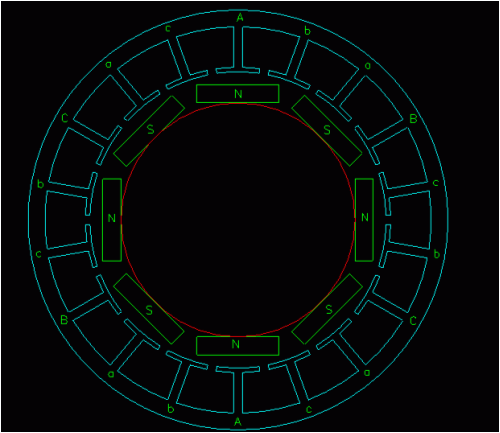

  pntrbl said   How the timing could possibly work with 8 or 10 poles, or 42 for that matter, makes no sense to me at all
I find it really helps to draw these things out:
Take a look at a single phase, e.g. phase 'a/A'. Notice how, at both the 12 o'clock and 6 o'clock position, the stator tooth is close to a N-pole on the rotor. Call this 'A' (capital A, wound CW). Now have a look at the 'a' at 2 o'clock, 5 o'clock, 7 o'clock and 10 o'clock. These are instead seeing a S-pole of the rotor and thus are wound in the opposite direction, hence 'a', CCW wound.
The same goes for phases b/B and c/C.
There's actually some logic in there... and it becomes much more understandable if you make a quick sketch of it.
I must admit these are a bit complicated examples with strange winding schemes. In practice we can often wind ABCABCABC (or 1-2-3-1-2-3) because we choose a pole number that's a sub-multiple of the number of stator slots. E.g. in the case of a 'normal' motorconversion with 36 stator slots and a 12-pole rotor the winding scheme is a very straightforward 1-2-3-1-2-3, with all coils wound in the same direction and following eachother in strict order. Besides, in 'normal' motorconversions coils span several slots, unlike in the example of the original poster where each coil is exactly one slot wide.
Confusing ? Naah.... Edited by Dinges 2008-08-09

That is a nice CAD drawing, what did you make that in? I made the other one up above in Google Sketchup. Adding the magnets with their poles in the picture does clear things up a little bit.

1st I'd like to agree with adric22 that that is a fine CAD drawing Dinges, and then add my personal Thanx for taking the time. A sketch makes what's happening in there abundantly clear.
I think it's starting to sink in now ......
