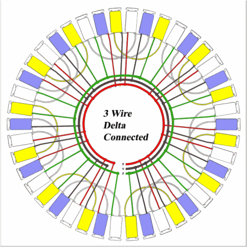

Hi all. Let me say this is a great forum. I have just wired up my first f&p stator. Unfortunately it was a 100 series stator and I wired it up 7 groups 2 pole star. I've since read that 100 series stators are not the go when it comes to HAWTs. I'm just wiring up an 80 series into a delta configuration and notice that no one has published a diagram for 7 group 2pole delta with 3 wires. I believe I have worked it out by combining the 6 wire diagram and the star delta diagram. I will publish a photo and schematic in the next couple of days to check with the forum gurus that I have got it right.

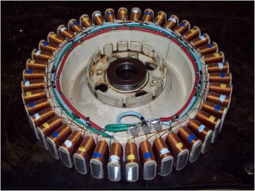

Posted: 10:32pm 27 Jul 2008
Here is the drawing and photo of my delta wired stator. I hope I have got it right or its a few hours down the drain.

Posted: 02:47am 28 Jul 2008
Yes, that looks right by me. I see you've decogged already so all the stator mods are done.
One of my hints is to use hot glue to hold wiring modifications in place. There is a reasonable amount of vibration in use and for general handling as well I find the glue makes for a more robust unit.

Posted: 06:43am 28 Jul 2008
Thanks Gill. I'll hot glue before moving onto the next step of my build. I have put some cable ties around the 3 wires and have covered it all in electrical varnish to protect it. I decogged it on the linisher belt attached to the grinder at work. Did a great job.
