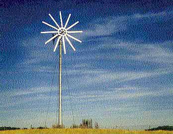

On the extreme end of things, Claus Nybroe from Windmission http://www.windmission.dk/index.htm found that for his particular combination of induction generator:rpm:diam, that lots was better and achieved a quite high rotor efficiency.
Windmission:
"In the theoretical windmill literature the maximum obtainable rotor efficiency is 0.6 . This is called the Betz efficiency, named after the man who calculated it on the basis of a rotor with an "infinite" number of blades.
The rotor efficiency is also named Cp, and in real life the highest obtainable Cp values are around 0.5.
The 12 bladed Windflower rotor, for example, operates with a measured maximum Cp value of 0.47, which is very good. "
His blades are as about as good as it gets, they are very quiet (250rpm I think) with good startup torque to drive a high ratio gearbox... a nice combination and a .47cp
