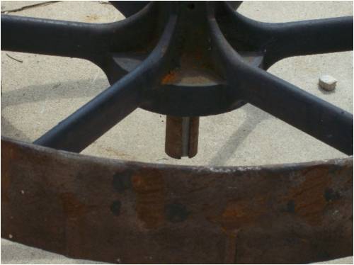

I only ran into one snag so far.Don't use a tape measure to measure bore diameters.I ordered a 1.5in shaft and when i tried it was too sloppy.I did learn something from that though.The wheel bore was slightly larger than the hub.So ordered a 1 5/8th shaft and stepped it to a perfect fit.

I stripped the face of the wheel and letting mother nature sandblast it for me(suface rust).
The outer band is pretty much formed and just need to design the brackets.

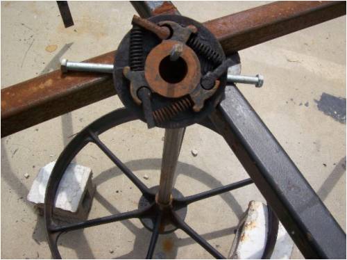

I see the camera works now. What in the world is that ...looks like a one way clutch doing in the scheme of things.

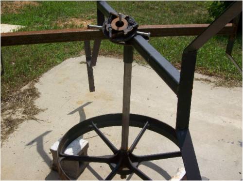

The Wheel is back on it's patio surgery table for the mag insertion and band attachment.I think i got the right stuff for glue.The hub is only one way and the bolts are just there to show where the setscrews will go.
The blades are built but will be the last to install.If you need a pic of them let me know.But you know the shape and same thing
just two more.
Has i said i'm working on the tower.
