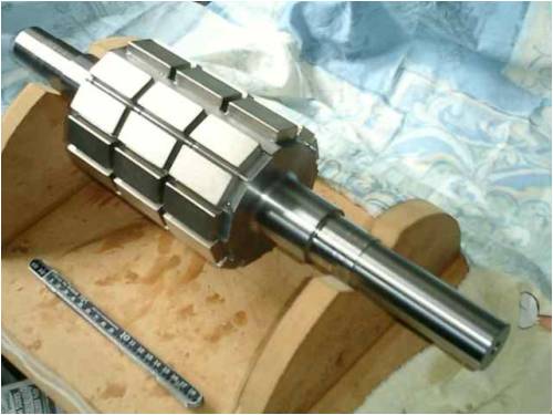

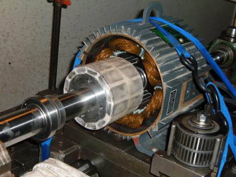

After the first small motor conversions (none are yet flying) I decided to tackle a larger project. About a year ago I finally acquired an old 10 hp motor to be converted to a permanent magnet (PM) generator. Work has been progressing slowly but steadily. Initially I intended to just make a new PM rotor for it but later decided to do a full conversion: a new rotor and a rewind.
This is so far the largest motorconversion I undertook. It will likely be the final one too. Larger conversions are frought with too many problems. A 5 or 7.5 hp motor is the nicest size, I think. 10 hp is just a tad too large (for me). And to think that Zubbly was considering doing a 25 hp conversion... (me shudders). This is also my first conversion where I use the 'JacquesM' method of decogging, as opposed to the usual helix-method. Hopefully the theory and calculations were correct, otherwise I'll end up with a 20 kg magnetic paperweight.

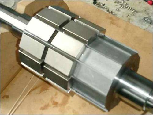

The progress so far: the coils in the stator have been removed (sept. 2007). A new rotor has been turned and milled (finished in march 2008).
At the moment I'm glueing the magnets on. 36 pieces of N42 2"x1"x.5". A scary job. Sometimes things look nice on paper (or the CAD screen), till you finally hold the workpiece in your hand in real life and see and feel how large and heavy it really is. The photos don't do justice to it.
Anyway, I'll try to describe the progress on it in this thread. Plenty more photos, along with short comments, can be found here:
http://picasaweb.google.com/motorconversion/75KWMotorConvers ionBlueMonster
Hope others will enjoy it too, even though this board is mostly focused on using F&Ps.
Peter.

Not sure what browser you use, but to see the full-size images, you can click either on the magnifying glass or on 'view largest photo'. Alternatively, you can go to my old gallery (http://www.anotherpower.com/gallery/album68?page=5)
If that still isn't clear enough let me know and I'll either send you the CAD files (.dwg or .dxf format) or zoom in on the parts you're interested in. Anyway, it's just a plain 'Jam' conversion, as explained in the decogging tutorial. It worked for JacquesM so I expect it to work for me too, but it's still a bit exciting as there's a lot of time and effort (and money) invested in this conversion which uses a method I've never used before.
As far as induction grid tied goes, it may perhaps be an idea to still rewind the motor to, say, an 8 or 12 pole (if it's originally a 2 or 4 pole). The rotor wouldn't have to be changed, but rewinding to more poles would mean that it'd start generating at a more usable RPM without the need for gearing (or at least, could use a much lower gearing ratio).

This looks fantastic. I really like some of the new ideas, like the fences on the rotor to keep the magnets from drifting around as you locate them.
As I browsed through your pictures, a few things came to mind.
Does your hub plate have to be stainless? You can use mild steel: easier to weld, and you could conceivably build it with stock components, ie., sprocket and hub assembly.
If you make blades that turn clockwise, a bolt in the end of the shaft will help keep the hub on (I made blades before making the shaft, then realized that I had missed an opportunity by making blades that turned counter-clockwise). Just an extra safety feature.
There's a key on the back end of the shaft in your drawings. Are you going to put something there? Encoder? Brake?
Early pictures show a lot of effort to test the windings. Then you removed them. Did you intend to keep the stock windings at first? Did a specific test result make you decide to re-wind?

I particularly like the little ridges too. In fact, if it weren't for them, wrestling the magnets in place as they sliver around on a coating of epoxy would be practically impossible. The downside is it takes a fair amount of machining (milling).
The hub plate doesn't *have* to be stainless. But, I like stainless steel for its corrosion resistance. No painting and maintenance required. I'm lazy: I don't mind building it once, but I dislike maintenance and repair. Also, austenitic stainless steels (AISI 304, 316) are a joy to weld.
I'll keep the clockwise turning blades in mind, but it already was my intent to not only let it turn that way but also to lock all nuts and bolts by a mechanical means (either locking wire or locking plates). Especially the central bolt that connects the hub to the shaft. IMO, windturbines require aviation practices, standards and quality levels in building and maintenance.
Yes, the key on the back is there so I can install a disc brake on it, as Bruce has done with his F&P. I like the idea of 'belts and braces' safety. Furling plus a way of mechanically positively stopping the blade. This would also be handy during raising and lowering of the tower. I'm also keeping in mind Oztules' method (rather: Southern Cross method) of furling/stopping the windturbine, but at the moment I'm partial to a braking mechanism.
I still intend to mount a temperature sensor in the stator (don't know how yet, haven't considered these issues much so far) and I'd like to have a way to tell RPMs. Maybe an optical through-beam photoswitch and vane inside the motorhousing ? Don't know yet. But it would be handy in the case of star/delta switching. My 3hp conversion doesn't seem to have much problem running in delta (unlike the 130 W conversion, which shows quite a bit of torque ripple when wired to delta (and without an electrical load). I figure delta should be possible, despite the risk of circulating currents, which I think can be removed by carefully rewinding (identical number of turns in all phases).
You're right about the original plan to keep the stockwindings. It was originally a 4 pole and I intended to just build a new rotor with the Jam method. Then afterwards do another motor conversion with rotor and rewind. Zubbly's disease made me decide to do a rewind immediately on this motor. Unfortunately he passed away before work really started. I'd have loved to show it off to him and hear his criticisms.

http://www.anotherpower.com/gallery/album68/blue_monster_dra wing_3?full=1
Notice that the magnets are not at 30 deg (360 deg/12poles) but at 29.166 deg w.r.t. eachother. This method was described in the decogging tutorial (p. 14-19, 'offset method'):
http://www.otherpower.com/images/scimages/3538/decogging_tut orial_V1.pdf
It has been proven in the past to work. See this work by JacquesM (who seems to have copied it from Victor, who seems to have found it in commercial generators):
http://www.fieldlines.com/story/2005/1/8/2291/67790
Look especially close at the spacing of the magnets on the rotor, you'll notice that in one place (~5 o'clock in this photo) the distance is not equal to the other 11 places). Stator skewing shouldn't be needed here.

All magnets have been installed. Next step is to add some glass cloth around the magnets and cast the rotor in epoxy.
