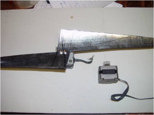

I'v ripped out 2 stepper motors from my old epson printer and have so far made the props and mounted them on the motor.

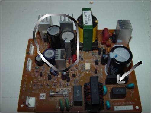

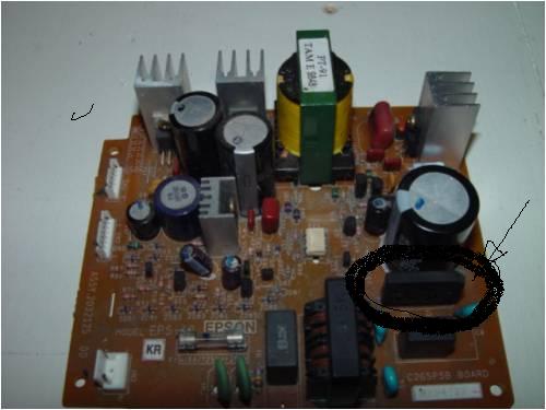

Heres some pics

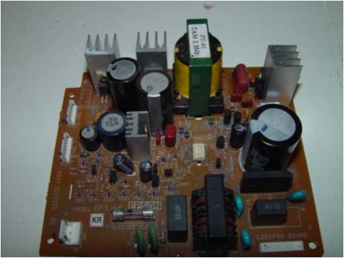

Theres a bridge rectifier with the arrow and there will be diodes that you may be able to use in the circle.
That big bridge is way overkill but you'v got it so use use it.
Oh is that a blowen fuse on that board? I hope the bridge isn't shot. Edited by Robb 2008-07-08

The rectifier is that flat rectangular plastic block, with the circle around it and arrow pointing to it. Close to the large electrolytic capacitor. Verify that it has 4 legs, 2 marked with '~', one with '+' and one with '-'.
Now, if you can scrounge an old PC powersupply, in there (again close to the one or two large electrolytic capacitors) you'll find a rectifier too.
As far as Radio Shack goes: Gee... You're the first one I've heard say such things about that store with its large inventory of electronics parts and knowledgeable sales persons. By now you likely know more about electronics than the staff...
BTW, before you toss those PCBs in the garbage, at least remove the aluminium cooling fins and the associated 3-legged components, which likely are FETs, rectifiers and/or voltage regulators. Remove the fuse and the white thingy in the middle (with 6 legs, an optocoupler) too while you're at it. It may come in handy in the future if you decide to play around more with electronics.

Sweet 1 rectifier down :)

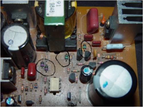

Robb is right, there will be enough diodes on that board to finish your project. But it's harder to explain where to find the diodes on that board, hence if you can quickly/easily find a rectifier, I'd go that route.
If you want to use plain diodes, there's your schematic:
http://www.thebackshed.com/Windmill/assemblyMini3.asp
Each black triangle-with-stripe is a diode. 4 of those combined in one house is called a rectifier. Yes, it's as easy as that :)
Ok... How to find suitable diodes on your PCB...
First, if you can, make a good close-up photo of the brown circuit board, especially the left-middle part with all the many small components. You're looking for tiny glass components with two leads. Likely, the circuit board will be marked (in white lettering) with text as 'D102', 'D302', etc. The 'D' indicates diodes here.
The glass diodes may be printed with *very* fine lettering, for example '1N914' or '1N4148'. Others have colour bands (for example, yellow-brown-yellow-grey = 1N4148). These would be fine for your application. But, basically, any old diodes you'll find in there should work (provided it's not a zener diode, marked 'ZD...').
If you can't find them with the above explanation or the help of Robb, post another good detailed picture and maybe we can hunt some suitable diodes down.

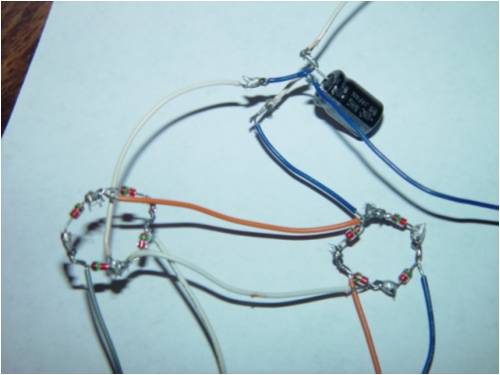

http://www.anotherpower.com/gallery/dinges/stepper_generator _resized
The 8 diodes are so small you won't be able to see them in this bad picture. But, it works, and should work for you too.
edit: it looks like there are some suitable diodes near the large transformer (large yellow thing at the top). I'm talking of the 2-leaded black cylindrical things with a white band at one end. Those are diodes too. If you can find 4 of them you'd have all the parts you need.

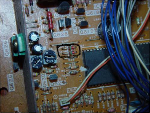

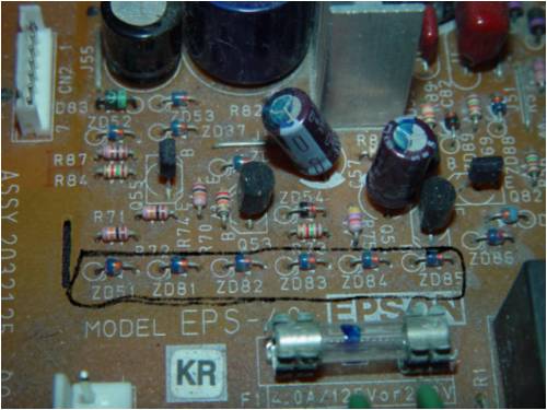

Posted: 07:05am 07 Jul 2008

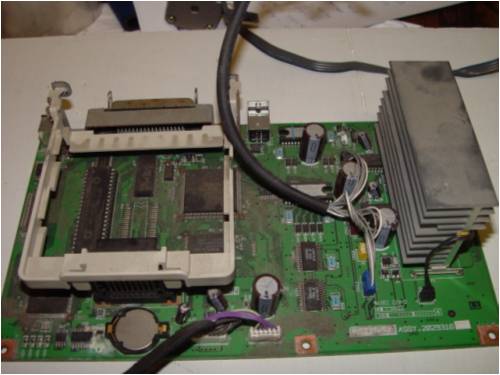

I hope those are diodes but I seem to have a problem. Theres 3 purple striped and 3 teal striped ones. Can they be mixed and matched?
I take it those are the zener diodes?
this is from an old vcr that i just took apart. Unfortunately there dont seem to be any rectifiers but there are more then 8 of those diodes.
btw are the strip an indicator of where the arrows point?Edited by jeen 2008-07-08

The 3 purple and teal (just learned a new word) diodes in your first picture should work fine, even when used mixed. Not much of an issue in your particular application.
The 6 zener diodes in your next picture shouldn't be used, just as other zener diodes in that same image. Zener diodes are used for voltage stabilization/regulation, not rectification.
The last picture from the VCR, with the two (or eight) green diodes should work fine too. BTW, if you look carefully at the white print under those diodes, you'll see the symbol of a diode: a triangle with a line at the tip. Notice how that line is at the same side as the black and/or green band around the diode.
