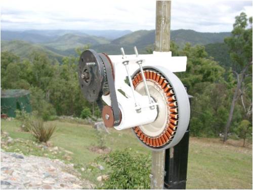

Pic of my geared hub ,,worked well ,,800 watts approx on one occasion that I was watching .
But the belt was not perfectly lined-up ,,so it "run" off and got stripped of it's ribs.Next time side cheeks will be fitted to the gearing cogs..
Thanks, for your reply ,,it proves that high output can be achieved with gearing in a strong wind .
Mine was neo-conversion rotor,2:1 gearing ,very strong wind, -It was a bit scary ,,but a hoot to watch..
