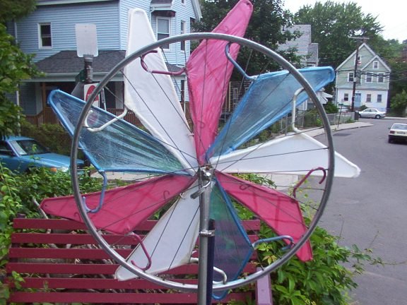

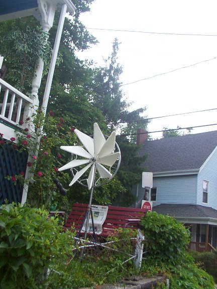

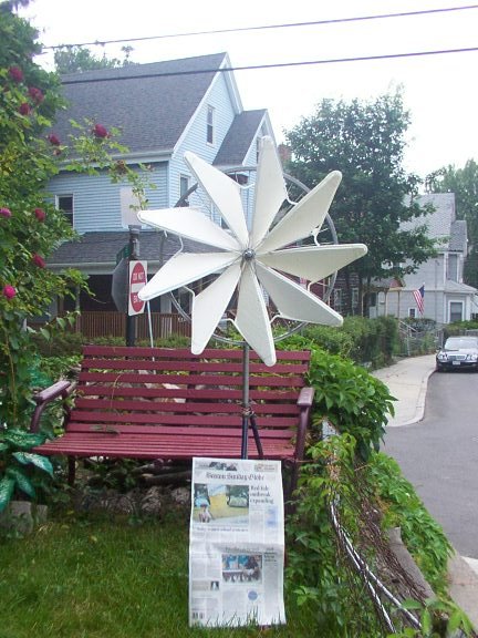

I love this thing. Philippe from Boston send me photos of his windmill he made with " a bicycle wheel, 9 plastic coat hangers, Styrofoam and tape. " He uses a clothes dryer belt around the rim to turn a small motor. Its very clever the way he used the coat hangers.

Thats a brilliant idea, you wouldnt notice the coat hangers if you walked past either!

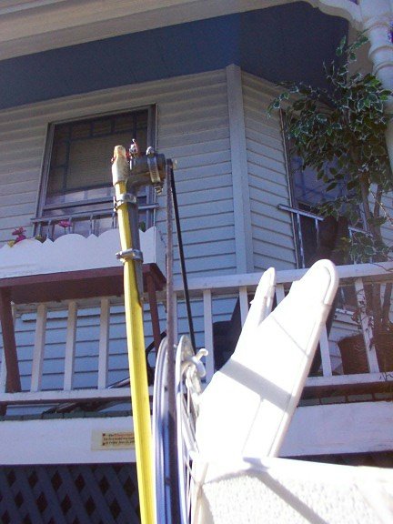

"This wheel rotates freely. At the location (hole) of the inner tube, I inserted one side of the axle of a rotating "bicycle wheel windmill". The wheels are perpendicular to each other. On the opposite side of the tire valve hole (windmill anchor point), I added a tail supported by a section of aluminum crutches. It is a "wheel on wheel" solution for smooth rotations in both horizontal and vertical planes. That horizontal bicycle wheel will likely be replaced by a scooter or motorcycle wheel, once I am ready to add the load of a generator."
