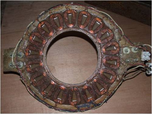

ps ..a better pic from fieldlines
i,m not the sharpest tool in the box....but i can sortof understand a picture.....as regards your question this post is basic but the only answer i have ........ Edited by niall1 2009-08-21
