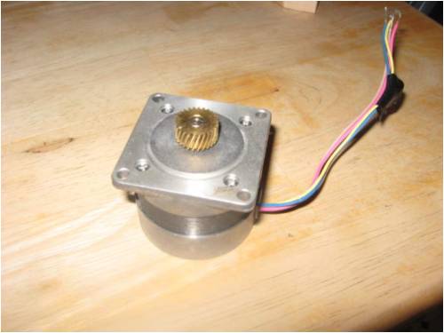

one of the step motors has the following specs on the label:
3 V
Coil 2.3 Ohms
Deg/Step 1.8
The other has the following:
5.4 V
12 Ohm/Phase
7.5 deg/step

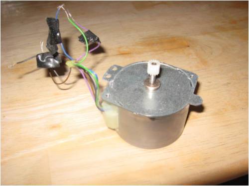

The third is smaller... with no specs.

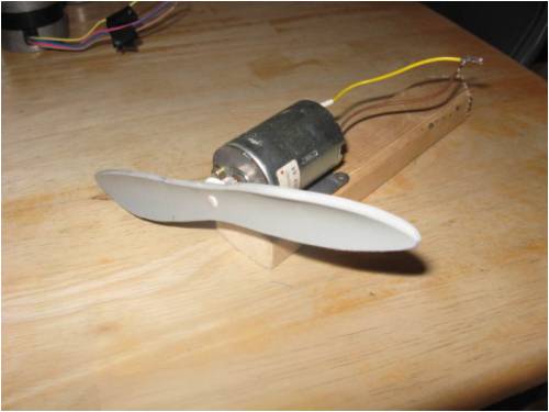

So, the smallest of the three I decided to start to put together into a mini...I got as far as mounting it and making a small prop for it.

Here's the first step motor I mentioned...
When turning the shaft, it feels as tho this one would be able to produce "juice" at a pretty darn low RPM (but again, I have NO idea what I'm doing or talking about)
Here's the second one....
And the start of my first windmill.. with the third motor.

" Do these step motors have any actual practical purpose? I guess I would need to define practical, but I'm interested to hear what you all might have to comment."
Sure, with fiddling, you may be able to get these to produce energy from the wind. However by their apparent size in the photo, they are going to be very limited in the amount of power that they will be able to produce! The size of the copper wire in the motors would be very restrictive. These definitely would be in the hobbyist class!
