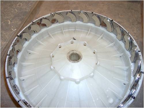

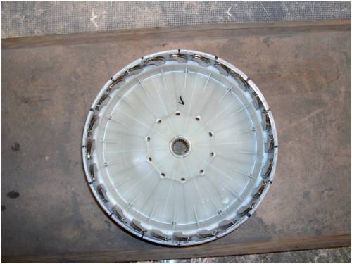

Here are a few images of the magnet hub. I placed the magnets with the hub on the shaft so I could see where to line up the magnets so they were in phase with each stator coil, and used a brass
rod to position them. I hooked this up and it spun at about 250 RPM without anything(glue) holding the magnets in place. They didn't move a bit. At this point I need to get a larger ammeter to do a bit more testing. I may have to build a piclog now. By the way thanks for the site and all the info. I love to tinker with DIY energy
projects. I felt like I won the lottery when I found a F&P machine here in the states, they are not easy to come by here.

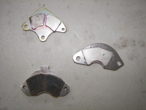

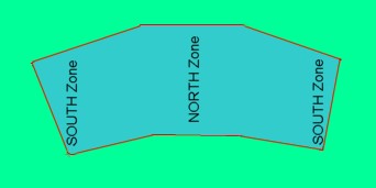

I've just tested some hard drive magnets and found on the flat face that faces the stator, They are not all one magnetic pole. Mine has one pole in the middle with the other at each end. Are yours the same as mine? I suspect so.
HDD Magnets
If so this magnetic configuration will not work as both magnetic poles are adjacent any one stator pole pole at the same time. It will have magnetic attraction to the stator laminations but will not cause the flux to flow through the coil and this is what induces the current to flow.
I can't think of a way of using these magnets unless they can be cut. I'll leave that for you to explore.

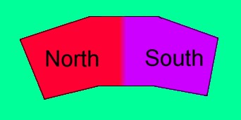

I have tested some magnets from the voice coil actuator of a hard disk drive, that look very similar to the ones you have used and they all have a north / south through the thickness orientation at one and the opposite polarity at the other.
The ones I tested had curved inner and outer edges. They were not flatenned like Gills' picture.
The ones I have would work. .. .. Gordon.
edit.. One thing I have noticed on your layout. The magnets are not a very good shape to suit the F&P rotor. I expect that the output waveform may be a little strange.Edited by GWatPE 2008-05-10

The magnets I have all have the north/south poles on the same face. They do work. My testing has just begun, but I
have set it up at 150 RPM and get 15V unloaded. With a small 12v 1.6A fan hooked up it operated the fan easily, reading 11.6V. I have yet to add more of a load. I had set it up spinning at a higher RPM, around 280, and got a voltage of around 30. I will need a larger ammeter to do more testing.
I am curious to see what the waveform looks like as well. I think I can use my multimeter and connect it up to a laptop and check that. I will post when I get to that.
The testing end of this is all new to me so I am learning as I go. I wish I had some sort of variable speed motor to drive this. I will have to get one.
When I came up with the idea to do this I had planned on cutting the magnets and arranging the poles in a more linear fashion around the hub, but then I read about a company that skewed their stators to help with cogging.
I thought, maybe skewing the magnet would also work. Plus the natural curve of the magnet lent itself to this.
It was worth a shot, you can imaging my delight when I got it together and lit my first light bulb, by just turning it by hand.

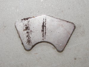

That they have "north/south poles on the same face" is not the problem as such, it is where these are located on the face that I see as the problem. I think Gordon says his has the poles at each end. I am surprised as I have several HDD magnet types here and they do not.
For those considering a similar modification, it may pay to check by sprinkling some iron powder or fine iron filings above the intended magnet and seeing if you get the twin arrangement I have identified.
If this happens, better go look for spiral and Gordon's single type like I am.

I use a needle to find the pole of the magnet. Filings tend to stick to where the field is concentrated. My method is hold the magnet in one hand and the needle in the other. Hold the needle at an end. Move the other end of the needle over the magnet surface of interest. The needle will align to the magnetic field.
The hard drive magnet shows a distinct null between the two poles. The needle will jump from pole to pole. The needle tends to centre in the area I have shown on the picture marked N and S
I think you will find that the line the filings make is not a pole. .. .. Gordon.

I set up a makeshift testing station today, with some adjustable belt configurations, and added some loads to check output. What I had laying around were 3 floodlights that are 12V 18Watt, and 1 fan 12v 1.58A. The F&P spun at 200 RPM and with all three lights hooked up I got 12.25V and 4A. The lights were at full brightness. I then added the fan and with all 4 working together I got 9.5V and 4.5A. The lights were a bit dimmer with this setup, but all 4 were working fine.
I don't really know what RPM is an average but 200 seemed
like a good place to start.
Do you guys have any testing tips that might help beyond this point. I have a charge controller for some solar panels that logs amp hours but I don't know if it can divert the load or if it only shorts it. I would hate to ruin it.
I tried to set up my multimeter and hook it up to the computer(It has a program called meterview, that is essentially a scope) and I was able to get it to log voltage, but then my computers battery died and needed recharging, so I didnt get very far. I also dont know how to hook it up to get a proper reading. Do I isolate one of the phases? Perhaps you folks could help with that.
All the hard drive magnets I came across have a N/S pole on each face, with the center being the dividing line.
I would still like to try to skew the magnets a bit more
to eliminate any overlapping of the poles, but they had a natural tendency to position themselves where they are in the photo so there they sit.
I do not know what a regular F&P output is so I dont know if this arrangement is better or worse than usual, but I am pleased enough so far. I can charge batteries with that.

This may be purely accademic now as it would seem that the power output from this modification is less than the original design. The increased air gap and the non ideal pole shape would probably account for the reduced output.
I had tried using the hard drive magnets in an early axial flux design, but this did not work out either.
BTW did a needle test on your magnets indicate a pole along the line that the filings made? .. .. Gordon.
