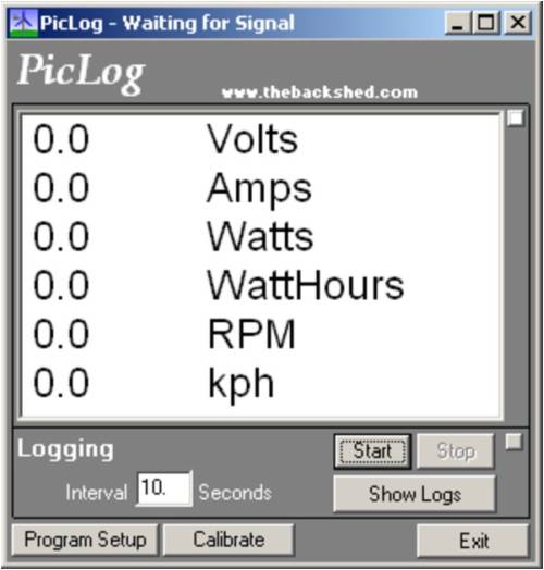

This site has the PicLog that you can make yourself. The site shows pics of the old PicLog program, but the current one logs: Battery Voltage, Amps, Watts, Watt/Hours, RPM, and Wind Speed. What more could a bloke need?
