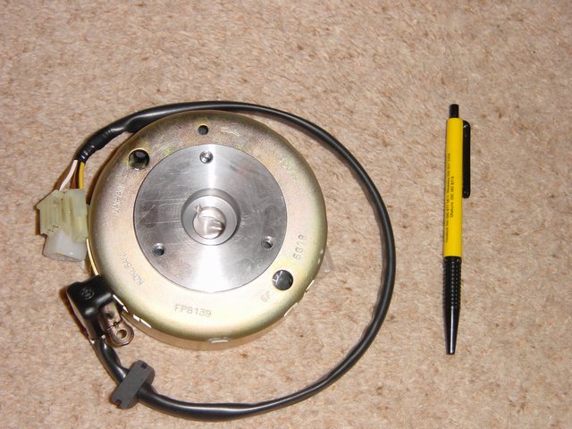

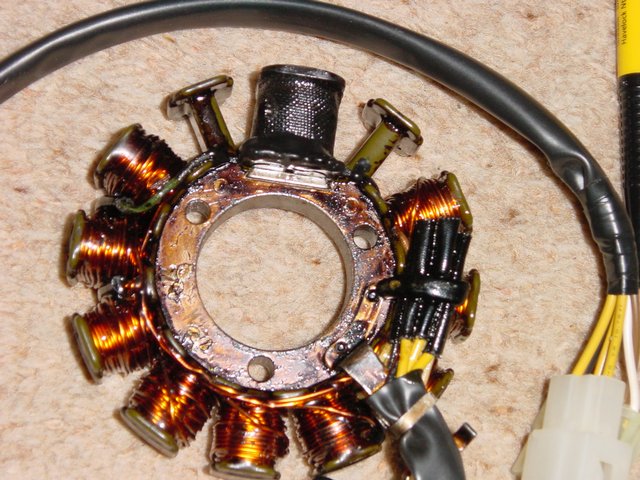

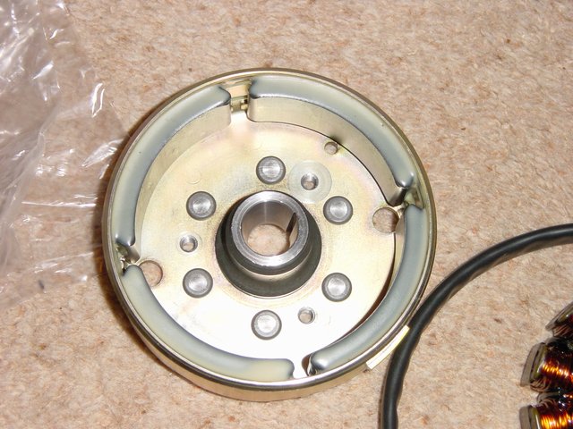

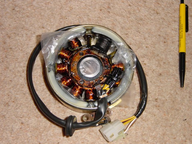

I have just acquired a nice magneto/alternator made by Kokusan in Japan. After some searching on the net found out that it is usually fitted in dirt bikes with CDI ignition. It is small but very solid and heavy (I'd say 2.5kg or so) - no plastic here, even the stator is all metal. Has 4 strong permanent magnets, 9 charging coils, 1 trigger coil, magnetic (RPM?) sensor and is very much like F&P motor (static stator and spinning rotor around it). Pictures follow below.

              Could you check to see if the 4 magnets are in fact that or a magnetic block of several North South sections?

And thanks for the reply. You were right - I just checked with a little magnet and it looks like every block has 2 magnets in it. If you go around, it is N-S-N-S-N-S-N-S, total (4 blocks x 2 magnets each) of 8 alternating polarity magnets.

Expect cogging to be an issue though the magnets can't be that powerful considering the plastic bag wrapping to extract the stator from the hub. (second photo)

Thanks, Gill. There is a point right opposite the 3 yellow wire sleeves where a few (looks like 2 - but maybe 3?) wires are twisted together. The problem is that whole stator is covered in blackish epoxy (?) and it is stone hard - is there a way to disassemble it somehow?
The wire looks 0.8 or 1mm diameter. Magnets are quite strong, it takes quite a lot of effort to pull the stator out of the rotor.

I tried to scale a guestimate from your third picture .... looks like maybe 3 tight wound layers at 15 to 16 turns per layer plus some scramble wound on a 4th layer (?) .... 50-60 turns (?) .... a trial coil will answer that fast !
