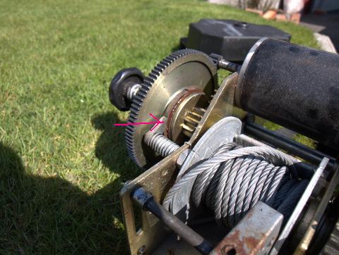

just a little bit to add on electric winches...well as least mine anyway...i can only comment on this model...
i used to use it on the mill and it worked fine ...but one day i noticed the characteristic clicking sound it made had stopped ......this turned out to a failed spring on the ratchet lock ...this allowed the mast to creep (back feed) if the motor was off...a bit unnerving to watch
i did reform the broken spring end....but only used it once after that.....
if the winch was used on a flat pull nothing unnecessary bad might happen ....hoisting something would be a different situation ..i think Edited by niall1 2010-04-18
