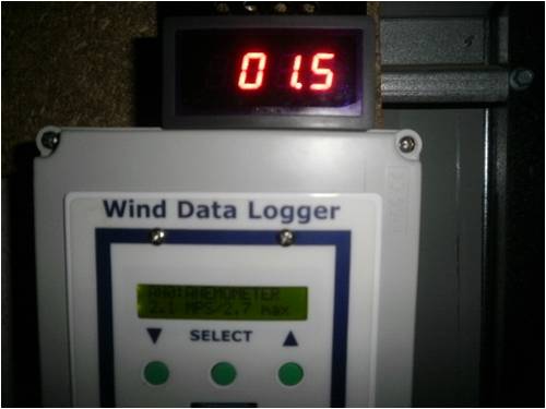

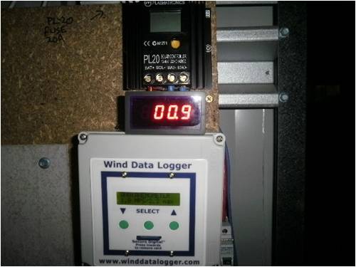

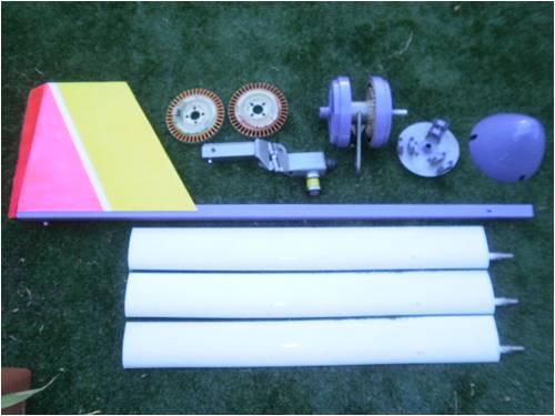

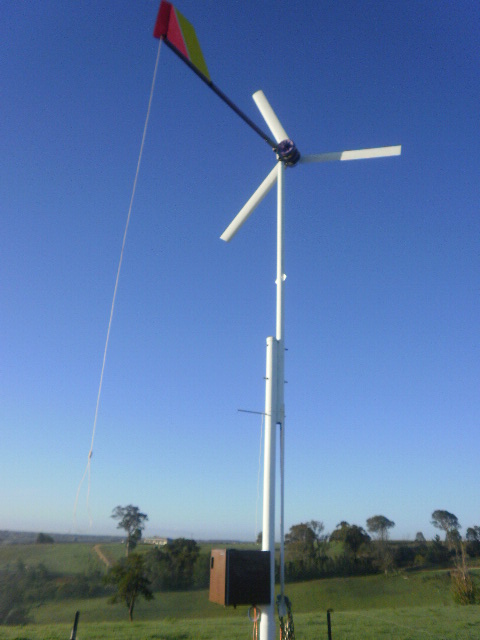

I hadnt seen that sucker.
I do note that in 4.5m/s it makes 80W
thats about 1.5A @52V
The Phillm Machine, with furling @3m diameter
makes pretty much double that I'm seeing 3-4A in the same wind.
I get the same 80W in just 3.5m/s
and 50W in just 2.2m/s
900W @14m/s is fairly howling for windspeed too, compared to the 1KW at 9-10m/s out of the Phillm dual.
Cost looks prohibitive at $3500.
Phills all up with blades, ready to roll with stators, and install on the pole with CAP voltage doubler is basically half that. (and if you build some bits yourself like the voltage doubler and supply the F&P's -much less again).
I do like the shiny appearance but I need more details on stators supplied to believe the output.
Gordon has only ever seen 890W out of the 100S in Delta and for this turbine to run in delta without a voltage doubler or MPPT type of thing would have a very high cutin rpm making it not suitable for low wind sites.
