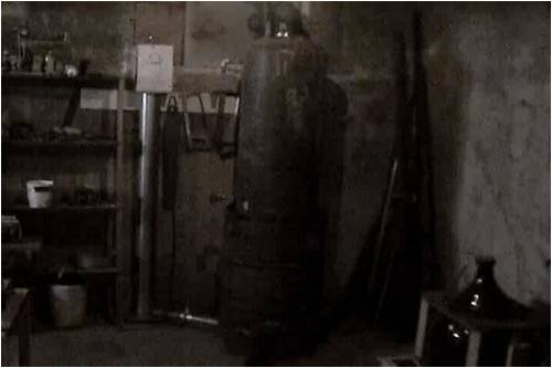

When I pressure test a vessel I do it of course by the conventional method
.....pressurizing with cold H20 and not with steam or compressed air!
all that happens, should the vessel fail is, it springs a leak. At the same time you can detect even the slightest leak because without a "gas cushion" the pressure drop shows up within seconds.
I did know that a hot water tank does not get CSA approval (here) unless it is engineered to at least twice the normal operating pressure.
....else I wold not have gone through all the trouble welding together a barrel wood stove with that tank being in effect the lower chimney section.
Like I said my cam takes lousy pictures indoors.
..and now I am really embarrassed!
I noticed on the right of the picture you guys can see that I make all kinds of other"home-brew-power"..
....or "power-home brew"
I forgot to wheel my ferment jug out of the way...
Would you believe the "it's strictly for medicinal purposes" line?
But I do thank you for your concern.

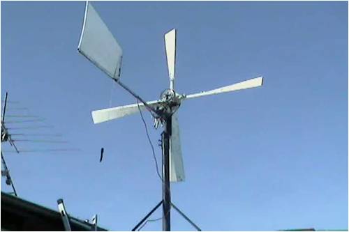

That looks to be a hell of a lot of twist in those blades.
I would think they would be rather noisey with a few rpm on them.
Sounds like a very practical way to make a set of blades with the ply.
Pete.

I wish to address why I "twisted" my prop and how I got the idea for the construction method.
I can't take credit for either.
WW1 props were made exactly the way I make mine!
Then the "twist" and the fact, that as you also must have noticed blade width which remains the same from root to tip.
....not like everybody else does it using a narrower width near the tip...where you get your best power yield.
I had a lot of opportunities in my professional life to closely study "Herc" props, especially when that happened:
I had no trouble to stand there all day and feel the torque of the prop every time there was a little bit of wind that day.
I was impressed!....as you are also able to observe the
prop blade width is not tapered over the entire length of the blade....also they use 4 blades not 3 like everybody seems to fancy for windmills.
So, again I can`t claim credit for what I simply copied from a Hercules Transport.

Back to the "twist" as you call it.
With the WW1 laminate propellor construction method, cutting strips on a table saw, then "fannig" these like a deck of cards you can of course select any kind of "twist" you desire.
You can make it 65 degrees pitch change from root to tip or as little as 20 degrees or whatever...
I am impressed with the guy here, forgot his name right now, that uses the 2 offset guide rails/Alaska chainsaw mill method to make his prop...!!!!
But he is limited by the thickness of his stock lumber
as to how much pitch/distance variation he can "milk"
from a particular piece of lumber.
Also if you have a "knot" in the lumber, that will be a serious weak spot.
When I hit a knot when I rip my laminate slices I simply turn that "knot" section around so it overlaps and gets sandwiched with a flawless portion of the next strips.
Once the "fanned" stack is glued it is just a matter of minutes to sand the steps with an angle grinder and a decent "floppy" grinding disk.
Material waste is minimal....once you have set the rip fence on your table saw.
I just thought you guys might find it worthwhile to revisit World War 1 propellers and what does work so well for a "Herc"....and has worked very well on my

I just wanted to also briefly discuss this PVC pipe method to make a prop:
This method forces such a taper cut and the selection of the proper OD size pipe.
And again at the tips where you would get your best torque yield the blade then presents a minimal surface to
the relative incoming air flow.
With a spruce laminate you need not fear the resulting
force at the tip, which is vectored into the direction of
rotation anyway as the prop gathers speed!
With PVC not being the strongest Material that may be a good thing, that the tips yield less force....but where I live extension cords break in winter temperatures like a dry twig...and so does a PVC prop!..even if you taper it.
Edited by Bernhard 2010-02-04

Still interesting.
There has been much posted on many sites about blade design and i am far from a expert on this.
I would think your blades would be low speed due to the drag out near the tip that you quote where the power is.
Yes there is power in the tip as well as drag.
This design might be good if motor driven as you would want to get as much bite on the air as possiable.
There is mass information on windmill blade design around and as much research as well, and from my reading it is advised against the large tip area.
I understand you have a very good back ground and great knowledge but think you might be missing something in blade design when it comes to wind energy.
This dont mean your blades wont work as they have proven to work, but there will be negatives to them in windmill applications.
To start with they may be near imposable to stop in strong winds and burn your windings up.
The simple fact that you required gearing implys that they are low speed and you have induced losses with the gearing to start with.
A different design and the need for gearing would not be required.
Your blades are designed for torque rather than speed.
Its a fine line to get both in balance to suit a windmill.
Your work is good but feel there is limitations in the shape design when it comes to windmills and getting the best out of a set of blades.
Pete.

I agree with Downwind.assesment.
The power is out at the ends of the blade, the inner third is wasted space unless you have startup cogging.... then a deep wide pitch is handy.
The power out near the tips is the key. You can use the high torque design of the old pumper mills (I have one of these as well... very torquey at startup), or go for low torque and high rpms.... power is of the same magnitude.
The difference is that with lift type blades, we get very high tip speeds, which lends itself to much cheaper and more efficient alternator designs. The slower drag style lends itself to low speed high torque applications... water pumping and grain milling in Holland spring to mind here.
So for the same size machine as the 8 footer seen here, we should be able to get 1000w @30 mph into a battery set with an axial flux and TSR7 blades..... or 100A or so at 12v. I suspect this setup has not seen much over 250W.... and that is without a furling system that I can see.
So for power generation, we want skinny low drag tips, traveling at high speed, and developing significant lift... On a good day this gets us a CP attainable of around .3 ....if we design well. I suspect going the slow rpm and gear arrangement and induction conversion we will suffer at .1 or so.
The proof of the pudding is as always in the money trail. Power generating mills have skinny tips and a lift profile.... they don't do it this way to come second best.... its how they make their living.
4 blades is a less useful number to choose for two other reasons.... and the big boys don't do that either.
Firstly, if you do get into some RPM's, you will find that the blade set of a 4 blade unit will be unstable during yaw..... which is darn near all the time... so will rattle itself apart eventually. 4 blades is also more likely to be a lower TSR in most cases.... so a more expensive alternator in resources will be necessary to maintain the efficiency demonstrated by a 3 blade unit. Herc's dont change direction at 50 degrees per second like a mill can and does.... so their blades don't need this characteristic. They are pulling a brick through the air, so need grip at speeds where their tips are not at the speed of sound.
So with that in mind....2 blades would be more efficient than three.... true.
But when some bigger ones of these were tried by the big boys (1MW unit), their mills failed.... for the same reason. Even though they had teetering hubs to allow for the instability through yaw, it was too much in the end, and they settled on three as the best compromise between speed and stability.
The fan style blades will be good for water pumping and grain grinding... although 18 seem better at this as solidity comes in at about 30 mph and protects the mill, and gives extra start torque.... but not for power generating.
Bernhard seems to have taken all the worst aspects of design for electrical power generating windmills (slow blades, iron cored alternator and a gearbox) and has cunningly engineered a way around them to get something that worked well enough for his purposes. It is not something to be emulated unless your into tinkering for tinkering's sake..... and there is nothing wrong with that either. ..... but if your making the mill for powering your home, it is not the path to follow. It will cost you more diesel for the batteries than necessary.
For wind power generating, follow the big boys. They have done the research and have the runs (Mega Watts ) on the board.
For reliability, 1 moving part is best. just the prop /magnet shaft.... nothing else. This way you can get many thousands of trouble free hours of generation if you build the alt sensibly.
.............oztules

I should have left the same Saginaw arm up there as I had it the week before I took this picture...
it was also from my ex 10 foot C-band Satellite dish.
That's what I used to turn it out of the wind, when I wanted to "stop the prop"...
it gave me a swing of 170 degrees and my prevailing winds here are from 280 to 060 degrees.

This is about the myth, that wide tips create drag:
See, the rotors are root to tip same width.
On the Russian MI12 even wider at the tip.
The idea of narrowing the tip on a large commercial wind turbine is again cost cutting.
Wide tips result in higher structural loads and consequently require more strength at the root of the
blade...again, its an accounting decision and has nothing to do with aerodynamic efficiency!
Helicopters "auto rotate" in "wind mill mode" rather well. Would they not most pilots would refuse to fly one that can't!

Why? -to be honest I have no idea and the "testing" was merely an observation I made on otherwise similar aircraft with 310hp per side weight was similar too at Max take off weight every day (freight run)
Now for the choppers, being the mechanic I balanced blades for our Jetranger -perfectly! but in flight during turns you can FEEL the stick kick back with the rotor rpm However in a Eurocopter 3 blades there was nothing like that stick shake
as for the Hughies 500 well that sucker was smooth as with 5 blades (but noisy inside as transmission over your shoulder)
This is because when the blades are out the side of the helicopter they are doing all the work but out front doing nothing for the roll (swash plate changes the pitch as they go around), with more than 2 blades it is smoother to fly.
Aircraft with reversing props (turboprops driven by gas turbines) you'll notice horrible noises when blades are run in reverse pitch -airfoil not optimised for this condition but works well enough.
This is where I think you are at
-works well enough but not optimised.
Coming from the aircraft industry I have a few words of wisdom- Aircraft stuff and windmills are a fair leap, the guys such as OZ and Gordon and Pete and Phill etc etc
are right up there with the hugh Piggots of the world if you ask me, they have the runs on the board.
No-one is criticising your efforts, just steering you in a better "matched" direction to get some more grunt for free.
Its all a learning curve, and with some luck you're learning lots.
I like the can do approach and so do the boys with the expertise, thats why they are here, to help guys like us
