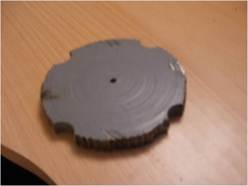

the centre of the rotor below was cut out by drilling around first with a 3mm bit (more than one... ..) and gently jigsawing it out , the cut can be cleaned up afterwards
you do loose the will to live doing it
.....but it is an option at least for the centre holes

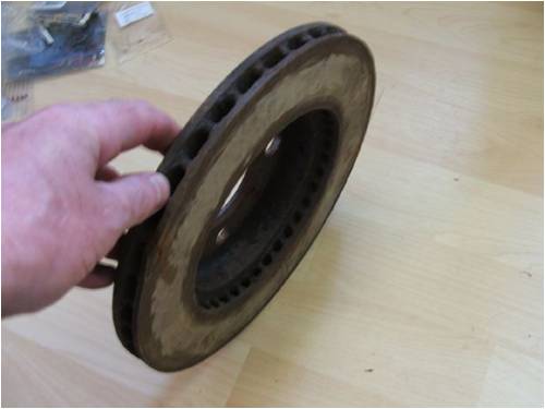

another suggestion might be the old otherpower approach using old car brake disks
2 front disks and a rear hub would be needed , assemble it with 4 lengths of all thread ..this way maybe you could just concentrate on your stator ..i never tried one but there should be some reading on otherpower on the pros and cons
