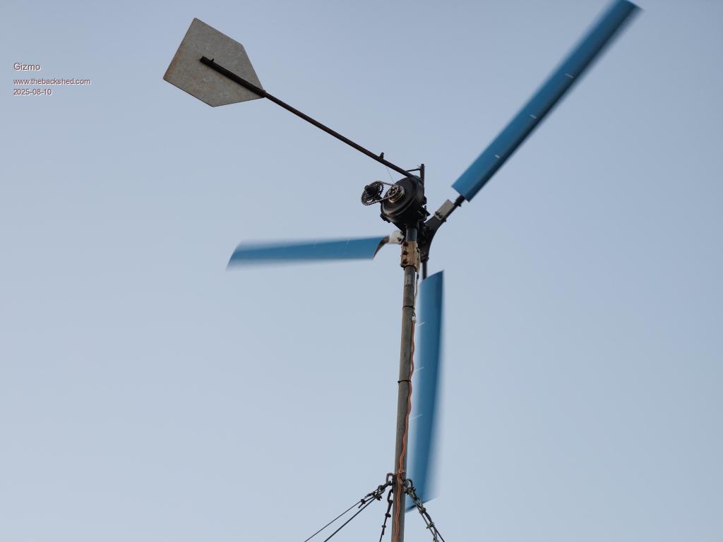

Well, its was one of my best so far, the windmill, and the explosion.
I build this one about a year ago. It used a ebike motor driven by a 2:1 bike chain,  GOE222 blades, had a diameter of 2.8 meters. There was a pull cable to furl the tail. It performed great, good low wind amps and peaked at 800 watts.

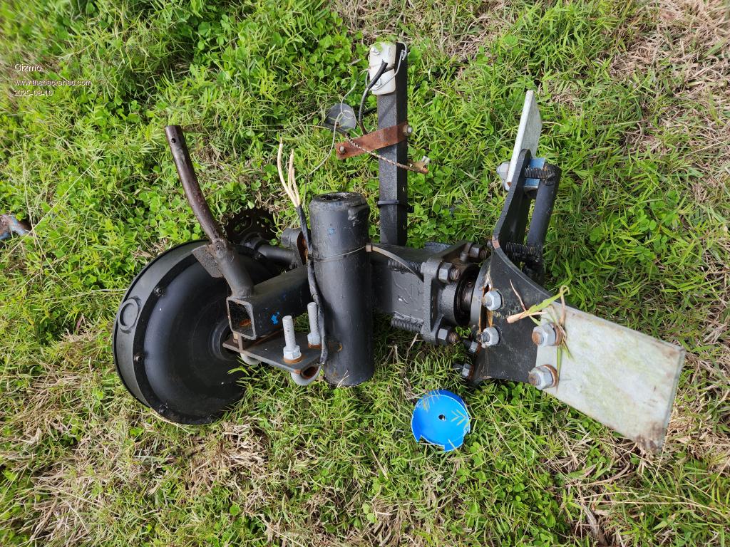

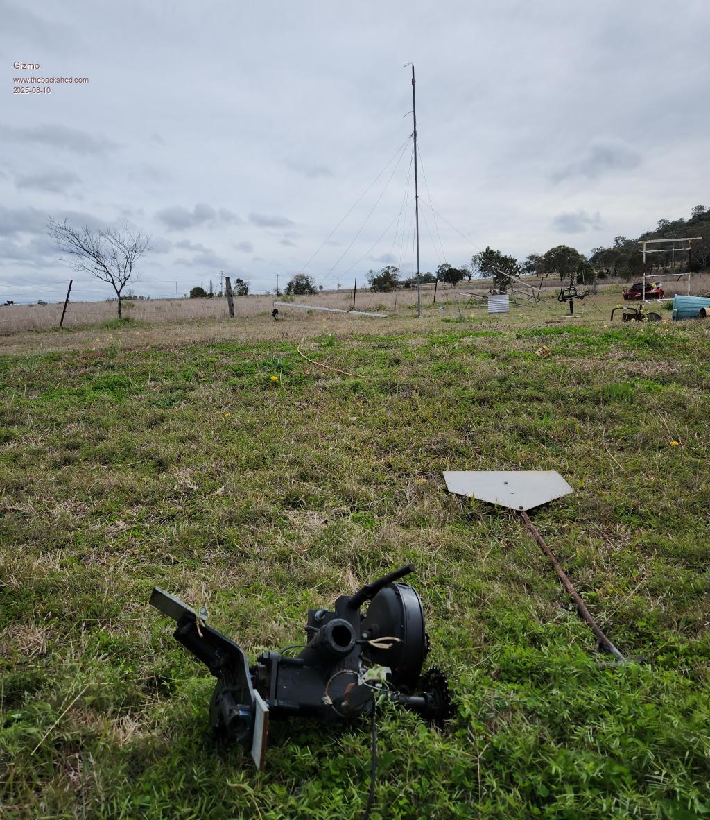

Yesterday I was taking a pee when there was a sudden gust of strong wind, rattled the house. After that I head a very loud rattle from the turbine, so quickly went out to have a look and shut it down. First thing I did was short it out ( big mistake ). It was still blowing a gale at the time, the sudden load caused the chain to pop off the sprocket, and now then turbine was unloaded, so started spinning up. I ran over to  pull the cable to furl the tail, but it was to late. The blades were spinning so fast the gyroscopic forces stopped the windmill from turning out of the wind. It started to roar, nothing I could do but run away. Next I heard a bang behind me like a car crash, and the nacelle landed on the ground a couple meters from where I was, about 15 meters from the tower.

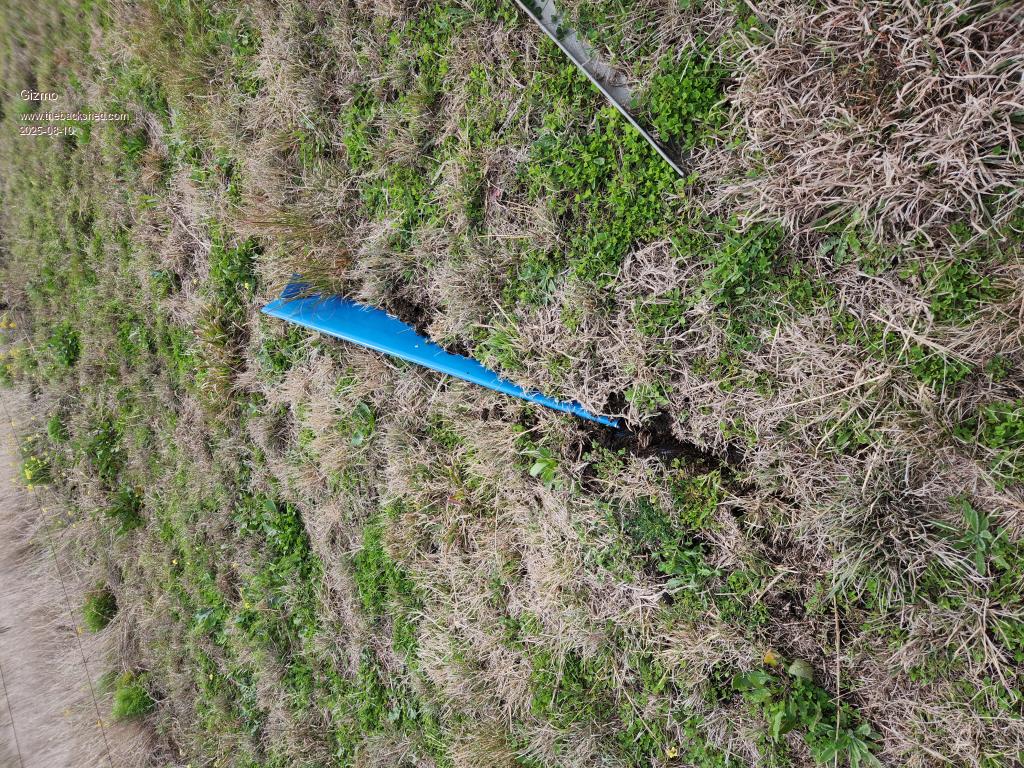

The level of destruction is impressive. First, the nacelle is secured over the top of the tower by a couple 8mm bolts, the pull cable, and electrical cables, all sheared off. Bits of this are spread all over the place. All 3 blades exited the hub, I've found 2 embedded into the ground, one is still missing, and I've walked the paddock in every direction for 200 meters looking for it. Even one of the guy wires for the tower was torn off, but a backup cable kept the tower up.
The alternator seams OK, I can probably fix the brush assembly and the nacelle itself, but the hub, blades, tail, etc are all write offs. I dont have many of the GOE222 blades left, sad to see 3 destroyed.
I dont know what the original loud rattle was, maybe the chain got out of alignment, that would explain why it popped off when I a put a load on it. Once the chain was gone the turbine was quiet, until it started to roar. I suspect the free wheeling turbine lost a blade, after that the vibration would have done the rest. The two blades I found show no sign of hitting the tower, only damage from embedding themselves into the ground.
