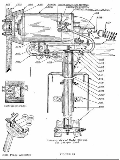

This picture is a parris dunn 1950's era. The generator lifts up in a strong wind to furl.

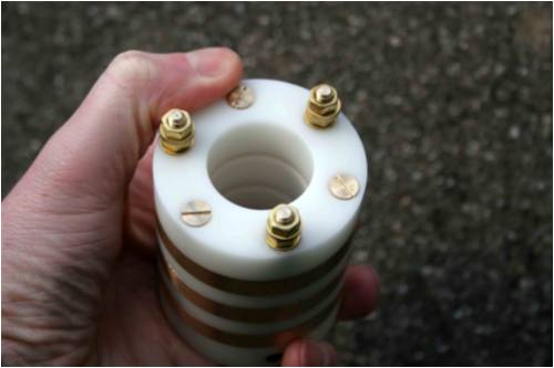

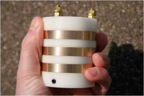

The slip rings on my mill are insulated with the high temperature phenolic fibre reinforced type insulation. Is the white insulator on yours, Teflon? The slip fingers and brushes I found were the important components in the assembly.

I will look forward to your next iteration of your machine. Slips look good, but we have done away with the AWP ones altogether. Better system for it I say.... but we have only 240v to run down the tower, so skinny wires can take a lot of twist if they have to (15A extension cord does nicely).

I used delrin for the insulator in my slip rings and my brushes are a custom blend of carbon, graphite and copper. I never found off the shelf brushes to transfer power efficiently, last a long time and and self lubricate without leaving residue and scoring on the ring surface. Brushes are a science all of their own.
