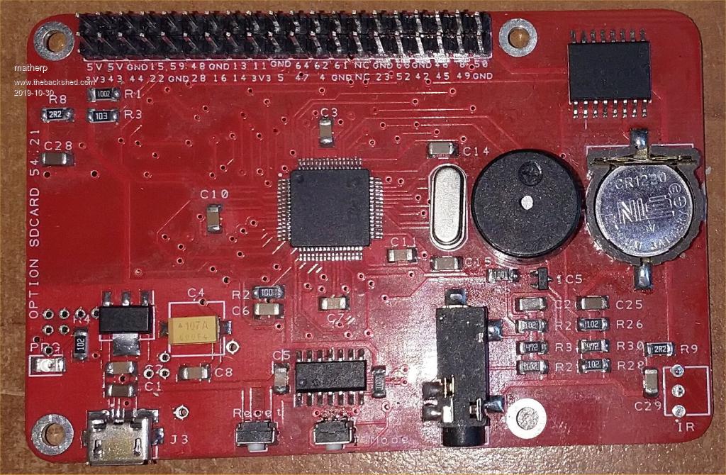

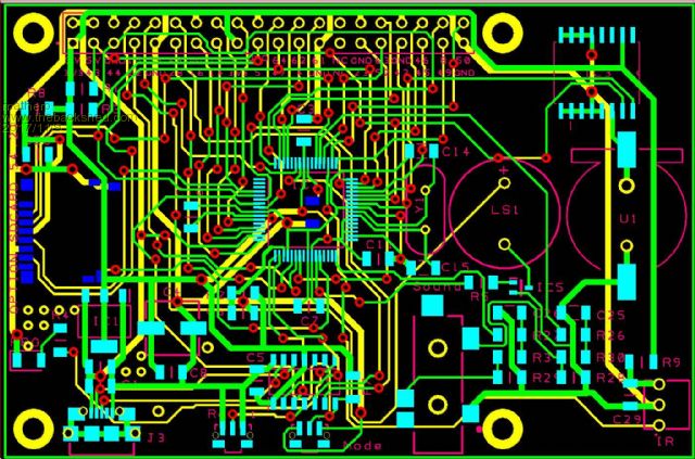

By popular demand (of one person ), here is a design for a new PCB for the 64-pin MM+. Copper pour areas are removed for clarity in the picture.
The PCB is the same size as a Pi 3 and will fit in a standard Pi case with all connectors and headers correctly placed as per the Pi.
It includes:
40-pin Pi HAT header with SPI, I2C, COM, PWM ports placed as per the Pi
DS3231 RTC and battery backup
Audio output as per MM+ manual
IR receiver
microSDcard
MicroUSB power and I/F connector
PIC16F1455 console USB I/F and PIC32 programmer
Buzzer
RESET and MODE switches
If this is of any interest, please advise. I'll post gerbers once the first version is tested and any bugs ironed out.

Very surprised to see no-one jumping up and down about this - because it sounds very good to me. If WW makes them available - I'll have one.

I've just found this while looking for something else. It's lovely! - and something I'd considered trying. Did it get any further, Peter?

Great idea, esp. fitting into prefab cases!

Hi peter
Very good idea. just one question: is-it possible to put 2 jumpers between 40 pins connector and pic32mx for COM1 lines who can inverting rx/tx , that permit to speak between rpi and MM+ via uarts. and others jumpers to isolate SPI bus (in this case, on hat, spi can be use only on board), or connected on SPI2, who permit use rpi as slave. Jumpers can by just small solder jumper

Nice! I like the way you got the GPIO pins to work out so well. I've just been comparing them with the RPi.
My soldering iron is getting itchy. I might have to get some boards made. :)
Thanks, Peter. :)
