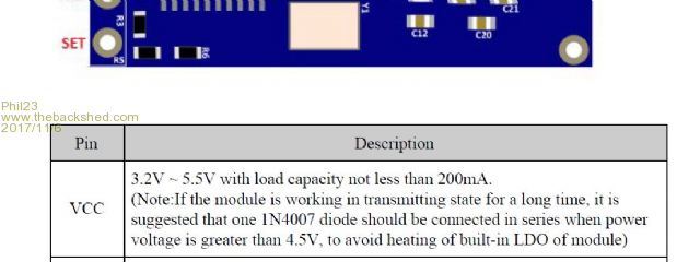

Do wonder though about the mention of lowering supply voltage in the documentation.
Phil
