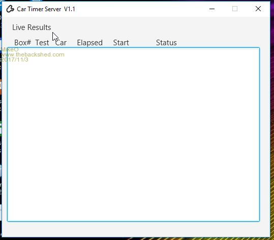

Most recently it has been incorporated also into another forum members system for lap timing off road cars (Khanacross) with results communicated via WiFi to the Results computer running a Java App and also to Android Phone. I won't elaborate as I was only responsible for the comms and Java apps side of this project.
Data transfer has used the UDP protocol so far but I am developing a HTTP GET transfer at the moment to use with the Pi-Cromite Web Server.
Possibly the quickest way to get you data to a PC would be to use the Java app as it could be very easily changed to turn it into a generic logger. Files are currently stored in files/folders by event and date.

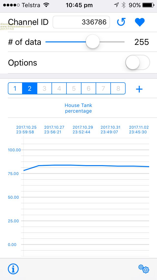

One more vote for the ESPBasic and wifi route. I have a tank monitor with HC12 to central MM, but keeping the data really never materialised until I got/modified @Mikeo ESPbasic code and send it up Things Speak each night. Things Speak is free for low volumes and keeps all the data for you.There is an app for iphone which shows it whenever you want to see it. I have power at the tank so the actual monitor is currently sending straight to Things Speak and also to the HC12 for when I have the central thing up if I am not playing with it.
The IPhone Things Speak app shows it like this. App was $1.49 for Iphone but seems to be many more choices for Android.

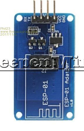

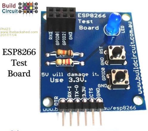

For flashing ESP-01's I find this little board handy.
Under 10 bucks.
Phil.

Phil,
I am just coming to terms with the ESP8266 boards.
Is the ESP-01 a suitable board for my use? I want to use it to link to my MM nodes to download data.
Why do I need the board you are suggesting? Can't I flash the ESP-01 directly or does this just make it easier?
Edited by Alastair 2017-11-06
Cheers, Alastair
Phil23
Joined: 27/03/2016
Posts: 1667
Posted: 05:30pm 04 Nov 2017
All of mine are ESP-01's, although I do have some ESP-12's I haven't used yet.
You don't need that test board, it just makes flashing a bit easier, hold down the GPIO0 button & hit reset & it's in program mode.
These are handy too, as the 4x2 pin layout is not breadboard friendly, there's a few variation.
That particular one also lets you power them off 5V.
There's a really good ESP8266 thread here .
Cheers.
