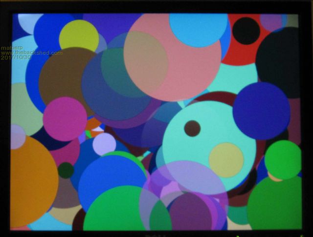

Please find attached version 5.4.14
2017-10-30_185432_mmbasicjessie.zip
2017-10-30_185448_mmbasicstretch.zip
This includes the ability to use a conected HDMI display as a LCDPANEL
OPTION LCDPANEL HDMI
See the video to watch GUI test running on a 1600x1200 HDMI display
The code automatically reads in the display size and MM.HRES and MM.VRES are set automatically for you. The display is in full 32-bit colour (RGBA).
The code works best on a Pi running Raspbian Lite as the Pixel GUI will break through the Pi-cromite display - anyone know how to fix this?
On a Lite install it works best if you disable the login prompt and the cursor
To disable the login prompt use
sudo systemctl disable getty@tty1.service
to disable the flashing cursor use:
sudo su
setterm -cursor off > /dev/tty1
All normal graphics commands are available including transparent text and BLIT and GUI commands will work as normal. Of course there is no TOUCH capability and mouse control of the cursor is a problem for another day.
Posted: 09:45am 30 Oct 2017
BRILLIANT!
Do you know what the performance is like on a RPi ZeroW? I don't want to erase my test SD card if its 'too slow' (i.e. best run on a RPi3 only).
Regarding TOUCH; there are many RPi 7" capacitive Touch TFTs. Do you think a single point TOUCH could be implemented somehow on these screens (i.e. no need for all the fancy multi-touch stuff that a capacitive allows for). These TFTs are much less 'reflective' as they don't have the horrible shiny resistive 'overlay' making for a much better colour contrast.

Posts: 12084
Posted: 10:19pm 30 Oct 2017
  Quote  Last question tonight - can you measure how long (in mS) to load a 1600x1200 hi-res bmp
241mSec on a Pi Zero W

Posts: 12084
Posted: 10:48pm 30 Oct 2017
  Quote  is MMBASIC useable on a full GUI install enough to see the graphics on the HDMI output.
It is fully usable but the clock and the load meter update in the top right and overlay the image - only a tiny area on a 1920x1080 screen. This can be largely negated by doing BLIT READ of this area and then BLIT WRITE at frequent intervals. This restores the contents of the mmbasic framebuffer to the screen
Of course, if you start clicking with the mouse other areas of the desktop will "break through".
To stop screen blanking on Lite
sudo nano /boot/cmdline.txt
Append " consoleblank=0" to the end of the line
To stop screen blanking on Pixel (Stetch: not tried on Jessie)
sudo nano /etc/lightdm/lightdm.conf
in the "[Seat:*]" section insert the line
"xserver-command=X -s 0 dpms"
In both cases reboot for the change to take effect
