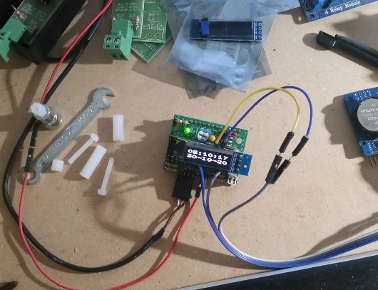

I am using the Mite to do 4-20mA to pulse and this
very tiny display is just right to show the 4-20mA
input and the divider and current pulse rate.

The ssd1306 driver can use any pins for SDA and SCK. They don't need to be the normal I2C pins. It uses a bit-banged I2C driver and not the PIC H/W
