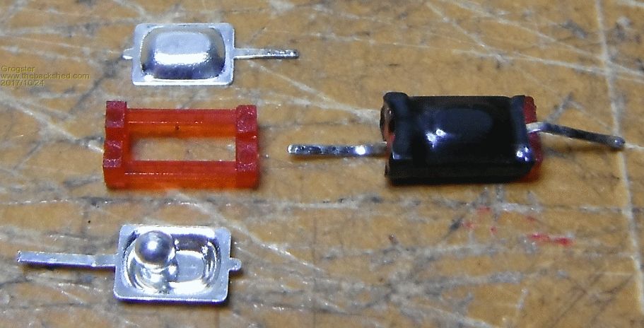

Here is a photo of the guts of a sensor I cut open:
You can see that when the unit is tilted, the ball rolls to one end or the other, and forms a circuit with the top and bottom cups. Extremely simple, and effective - once I disable the PULLUP option.....
