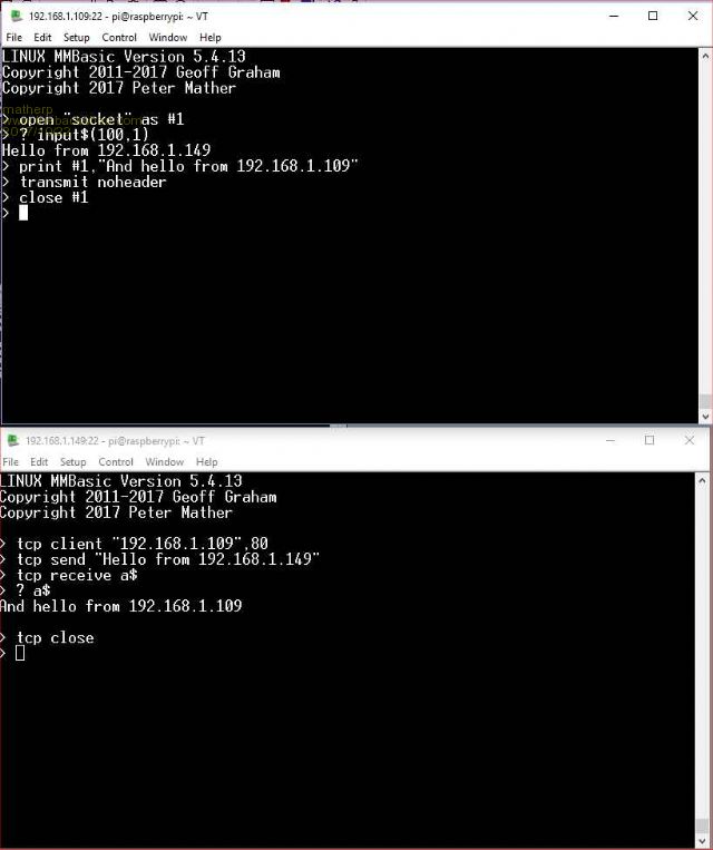

4. removed ability to run a disk program without using the RUN command
5. implemented TCPIP client capability
6. implemented TRANSMIT NOHEADER for TCPIP socket functionality

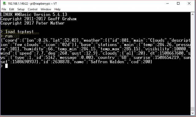

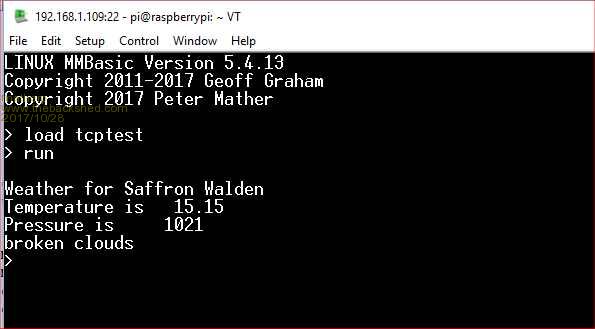

The TCP functionality is shown below using the existing OPEN "socket" capability together with the new TCP client. Also below is an example of using the TCP client capability to interrogate api.openweather.org
Option explicit
Option default none
Dim a$,b$,c$
Dim integer i,j,rlen
Dim m%(4000)
Dim MYID$="enter city code here"
Dim APIKEY$="enter your APIKEY here"
' get the IP address of openweathermap and open a client connection to it
a$=GetIP$("api.openweathermap.org")
TCP client a$,80
' construct the request for a weather report and send it
b$= "GET /data/2.5/weather?id="+MYID$+"&APPID="+APIKEY$
b$=b$+" HTTP/1.0"+Chr$(13)+Chr$(10)+Chr$(13)+Chr$(10)
TCP send b$
'set up a longstring variable and read the return message into it
LongString clear m%()
TCP receive c$
If c$<>"" Then LongString append m%(),c$
Loop While c$<>""
' trim off the HTTP header
LongString trim m%(),LInStr(m%(),"{")-1
rlen=LLen(m%())
' process the message, in this case just print it out
i=1
Do While rlen>0
If rlen>240 Then
j=240
Else
j=rlen
rlen=rlen-j
Print LGetStr$(m%(),i,j);
i=i+j
Print ""
TCP close

  Quote   I was unable to receive any data using this version and the browser reported "No Data" when I closed the running (web server) program
Ooops Left in a diagnostic change - sorry.

This version also includes a development I'm working on to parse JSON strings
JSON$(array%(),string$)
Returns a string representing a specific item out of the JSON input stored in the longstring array%()
e.g.
JSON$(a%(), “name”)
JSON$(a%(), “coord.lat”)
JSON$(a%(), “weather[0].description”)
JSON$(a%(),”list[4].weather[0].description
Examples taken from api.openweathermap.org

Print "Weather for "+json$(m%(),"name")
Print "Temperature is ",val(json$(m%(),"main.temp"))-273
Print "Pressure is ",json$(m%(),"main.pressure")
Print json$(m%(),"weather[0].description")

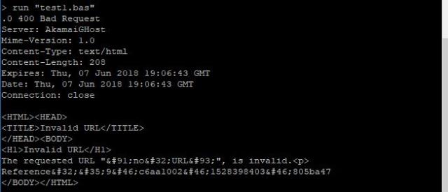

If the API request uses HTTPS such as DarkSky
Is there a way to get this to work without setting up a PHP server on the Pi and then using that to get and parse the data?
example
[code]https://api.darksky.net/forecast/APIKEY$/53.4399,-2.1065?units=uk2[/code]
When I use the code above I get this result
IF I change the get IP line to
a$=GetIP$("https://api.darksky.net")
Then I get this result
Yet if I do a tracert on https://api.darksky.net I get
