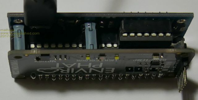

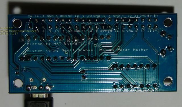

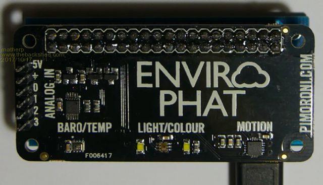

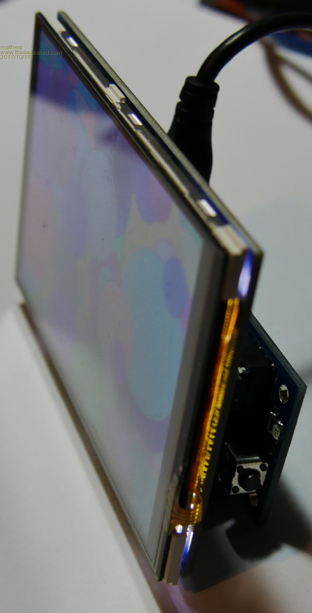

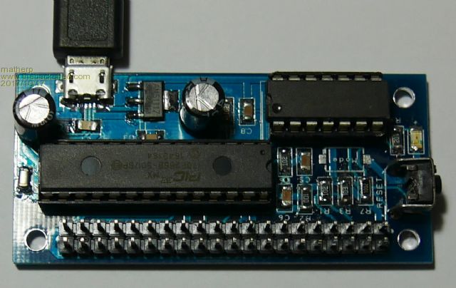

Here is the PCB made and populated and all works perfectly. If you want one contact WW or get some PCBs made. The last picture is with a 4" ILI9481 display and its loadable driver
sub mm.startup
ili9481 16,22,9,1
end sub
option touch 10,5

My involvement was only to request a total re-layout so the USB socket lined up with that of a RPi Zero so that RPi Zero cases could be used to house the MM HAT Stand!
Hopefully a couple of PCBs will be with me soon Edited by WhiteWizzard 2017-10-18

I had written some code for a couple of RPi add on cards and can't wait to have one of these PCBs arrive to 'tidy up' the wiring. It is going to make for neat solutions bearing in mind the multitude of RPi add-on modules out there (and most a very sensibly priced).
With 'stackable' headers and the 4" IPS then you have a nice 'BackPack' that you can mount HATs on and that can be easily coded for us non Scratch/Python people

There will be unpopulated PCBs, SMD modules (i.e. PCBs with SMDs pre-soldered) and fully assembled.
No prices yet - but as usual they will be as low as I can possibly make them for TBS members just so we can get the MicroMite 'out there'.
Updates will follow in a couple of days once I have assembled a 'test unit'

Posted: 11:42pm 18 Oct 2017
Found a typo on the silkscreening: pin 22 of the 40 pin header was labelled 22 instead of 2.
Corrected in these gerbers
2017-10-19_093510_HAT_stand.zip
Note this also affects the ILI9481 configuration - should be:
sub mm.startup
ili9481 16,2,9,1
end sub
