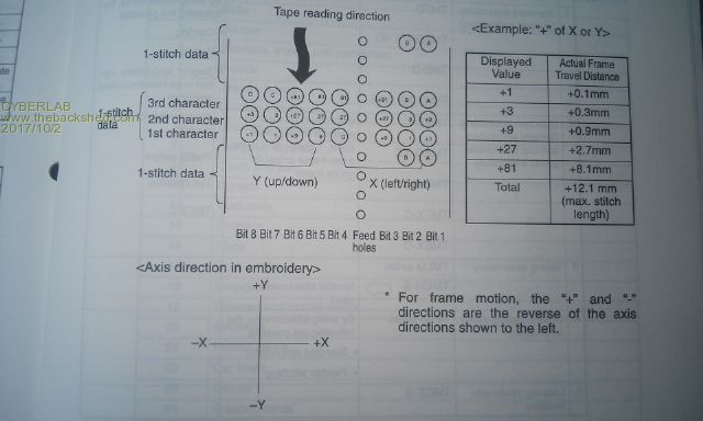

Hello Panky, first of all thank you for the tips on how to start my program in a modular way, as well as thank Geoffp, for this amazing minicomputer, as well as Grogster, Matherp and other collaborators. I started sending files to the micromite through teraterm using xmodem and saving them in the CF, and it was extremely easy !, the first 512 bytes of this type of files basically contain text, such as file name dimensions, max coordinates on axes -X, + X, -Y + Y from byte 513 to the end of the file contains coordinates in a kind of ternary code where every 3 bytes when decoding said code will have a numerical value in the range of 1 to 121 which equals to .1mm to 12.1mm of distance for X and another of equal form for Y, in such a way that by the size of our screen 240 x 320 I decided that 10mm = 1pixel. the graph will start at the center of the screen where the pixel of position Y120 and X160 will actually be Y0 and X0 as an example if decoding the first 3 bytes gives us as a result Y5 and X11 will plot a line starting at the pixel Y120 X160 (our origin Y0, X0) and ends in the pixel Y115 and X171 and if the next 3 bytes give us as a result -Y10 and -X4 will graph another line starting where the last line ends, ie in Y115 and X171 and end in Y125 and X167 and so on until the end of the file.
my next goal is a subroutine that read every 3 bytes from the file and decode the size of the line in the lcd panel
