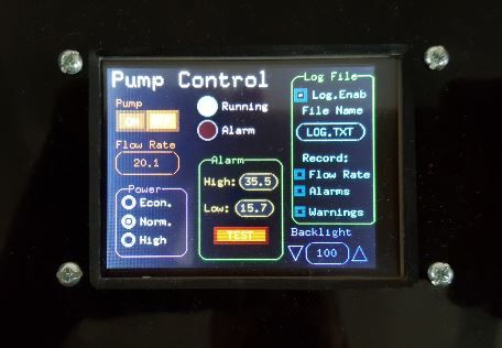

While testing all GUI commends on the MM Plus, I have found very useful the possibility to modify Geoff's program 'Pump Control" to fit into the ILI9341 smaller 320x240 LCD. (Thanks Geoff )
I hope it can assist many others. ..:
