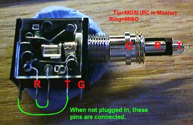

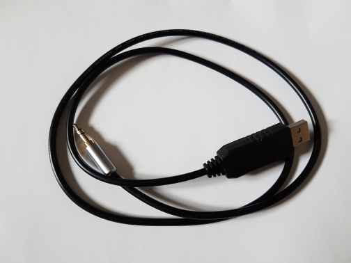

I have tons of MM devices where I bring the console connection to a stock 3.5mm stereo socket and then when I need to visit to check things I have a USB-Serial device with a 3.5mm jack plug on the end. Saves having to use a CH340G (or similar) in every unit and it is a more enduring connector than USB (or worse-yet, micro usb).
Using an OTG (USB Host adaptor) for my android phone (or a tablet), the cable above and this bit of software I can connect with my phone - this is really nice because it means you don't have to lug a laptop to every service call - simple comms to investigate is really easy and you only have to bring out the big guns when really necessary. It natively supports CP2102, PL2303 and CH2340G.
