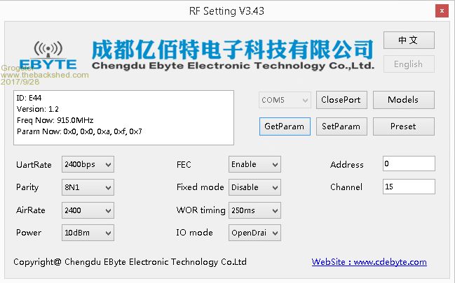

Module settings:

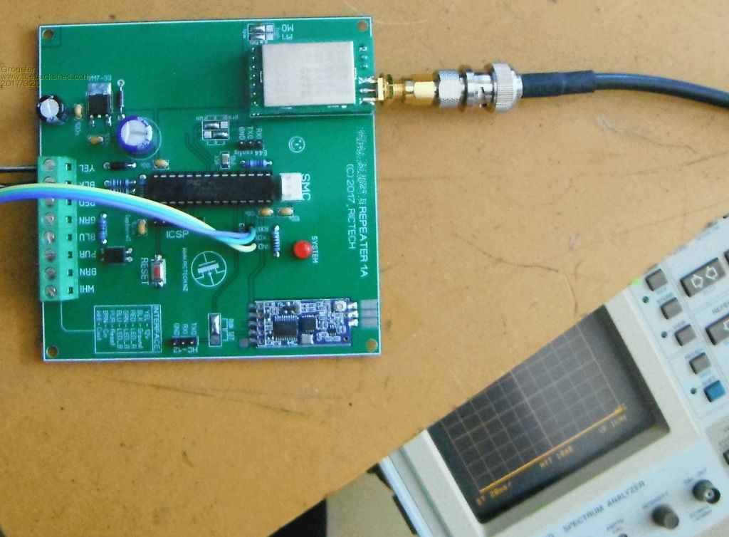

Module setup for testing:
Direct connection to spectrum analyser, 10mW output power.

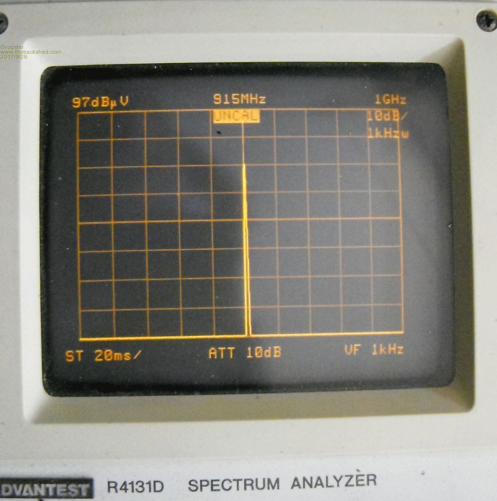

Spectrum @ 1GHz bandwidth:(500MHz either side of 915MHz center-frequency)

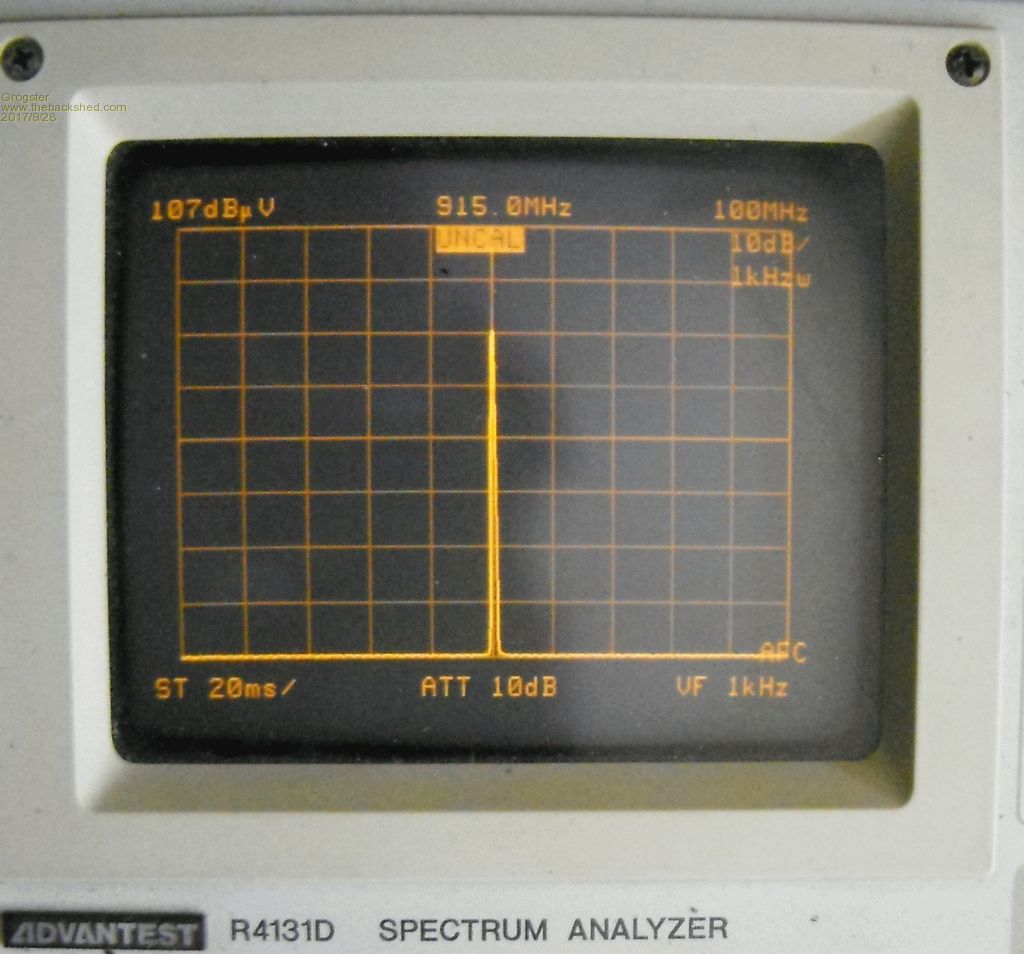

Spectrum @ 100MHz bandwidth:(50MHz either side of 915MHz center-frequency)

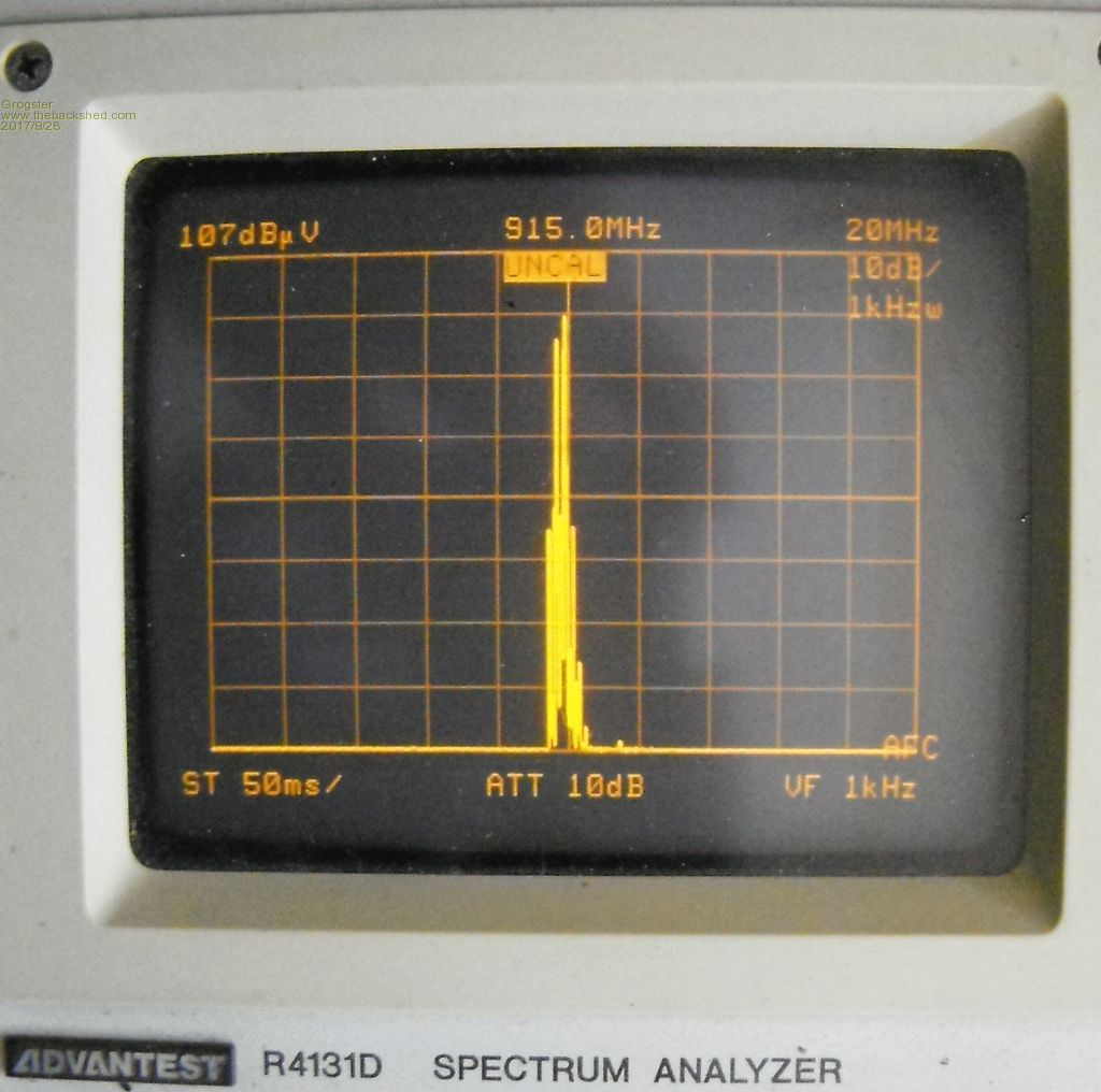

Spectrum @ 20MHz bandwidth:(10MHz either side of 915MHz center-frequency)

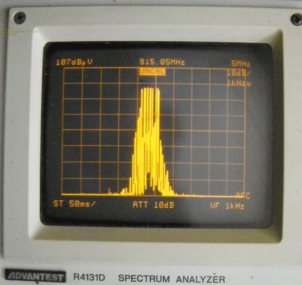

Spectrum @ 5Mhz bandwidth:(2.5MHz either side of 915MHz center-frequency)
I have to say that I am rather pleased with the results of this test, and they don't appear to be radiating any kind of harmonics or spurious signals onto the spectrum outside of where they are supposed to be sitting.
