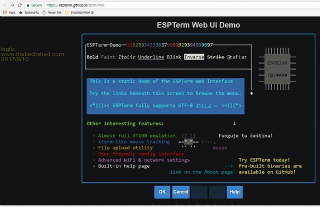

Finally - filling another gap in the MicroMite family
ESPterm is a tiny Webserver running on an ESP8266 which emulates a VT100
ESPterm allows to "webify" any Micromite just with a serial connection and no special Web/Network code at all
This gives you a full character based GUI to the MicroMite with optional touch/mouse support
tiny size, relatively low power
very low costpoint - typically a few $ only
no special SW on the client side - just a browser
no OS patches/maintenance - fits well with MicroMites
It was written by Ondrej Hruska in Prague - I only helped with some requirements & testing & some beer money
Ondrej did an excellent job, documenting everything on Github and having almost no bugs in many iterations
His goal is to make it as compatible as possible with all typical character based Unix applications & VTtest
The main limitation is the tiny RAM in the ESP - leaving about 30kB only for the application & Screen storage
Program space is less of an issue
- so we will get many more functions over time and quite extensive GUI & Help pages
Github ESPTerm

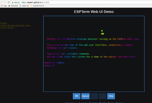

ESPTerm Demo
All the menu/help pages in the demo look exactly the same as the real thing
The current releases you find at
Current ESPTerm Release:
Flashing works with the usual tools, which were discussed multiple times in the Forum already
ESP Flashing

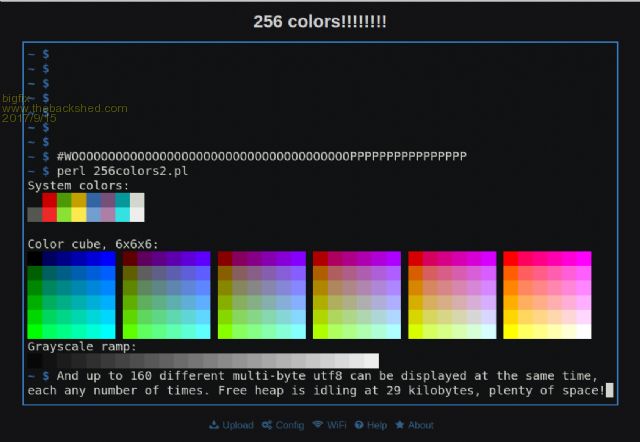

1.1.2 is here !
no further excuses not try it
New more interactive Demo at
ESPTerm Demo
Wifi Bug is fixed
Frontend got completely rewritten - works better across browsers
Chrome still looks best and also has optional fullscreen mode
Uses HTML5 now, faster rendering
256 Colors, Cursor styles
Many more config options in expert settings
For all details see release notes

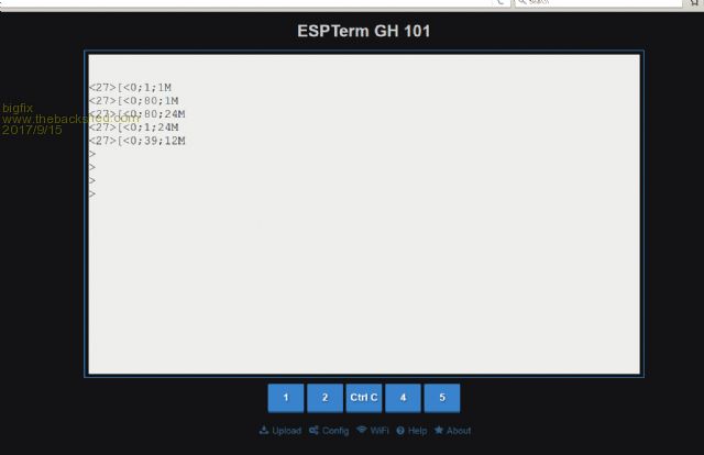

Posted: 10:36am 15 Sep 2017
Useful Code Snippet from Rob to test Mouse functionality:

it makes use of alternative encoding for the mouse location reporting - SGR (1006) is the preferred reporting method, URXVT (1015) is ok but not great, while the default encoding can not encode beyond column 95 if using 7-bit characters.
To exit type "x"
Mousebuttons are encoded in first Value - even the wheel works
Scren shows left button clicks in corners & center

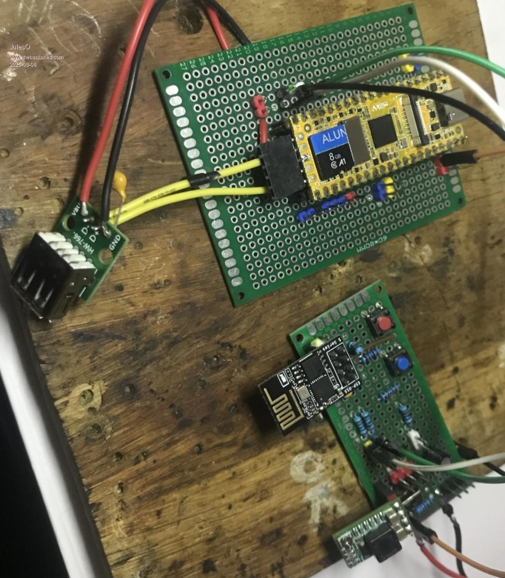

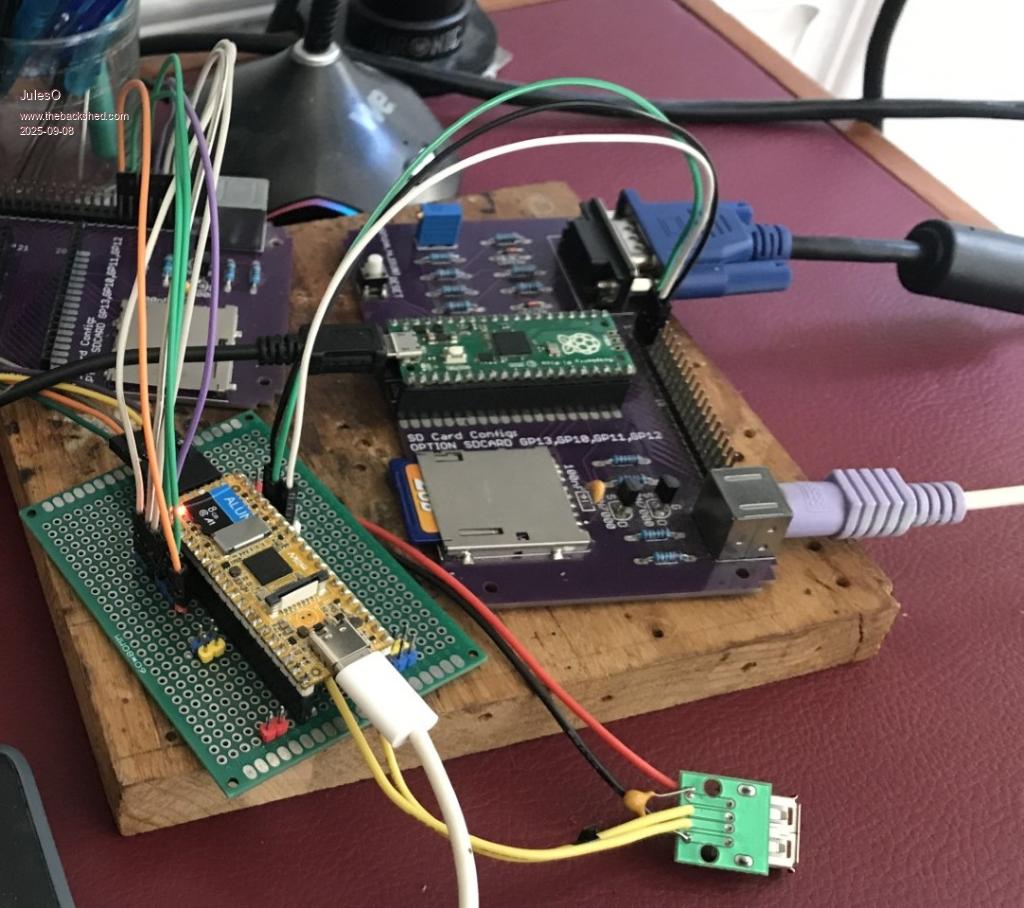

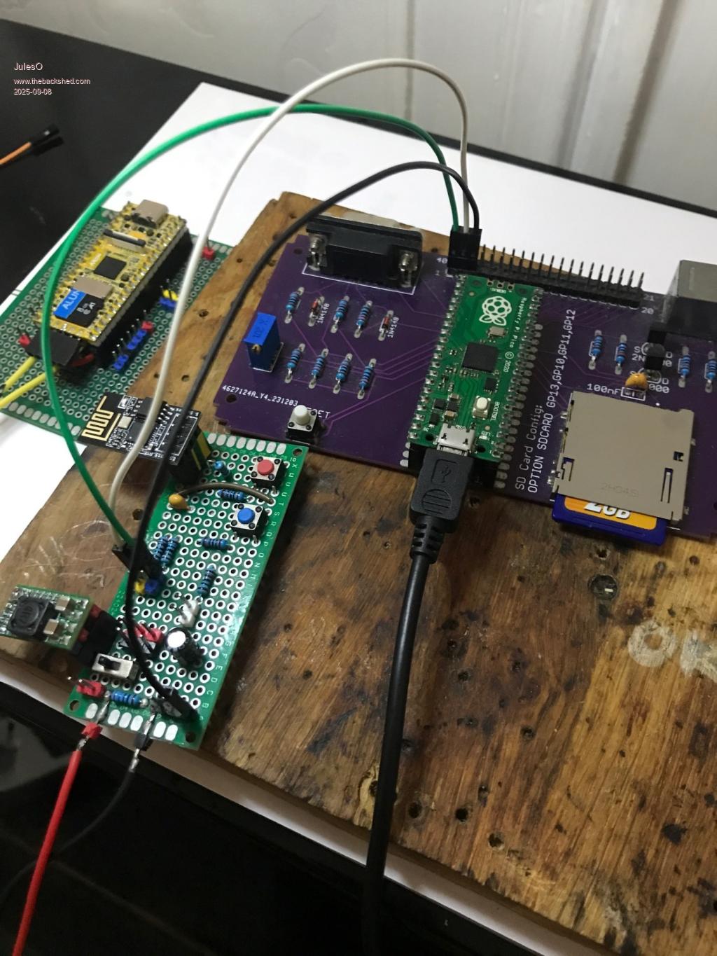

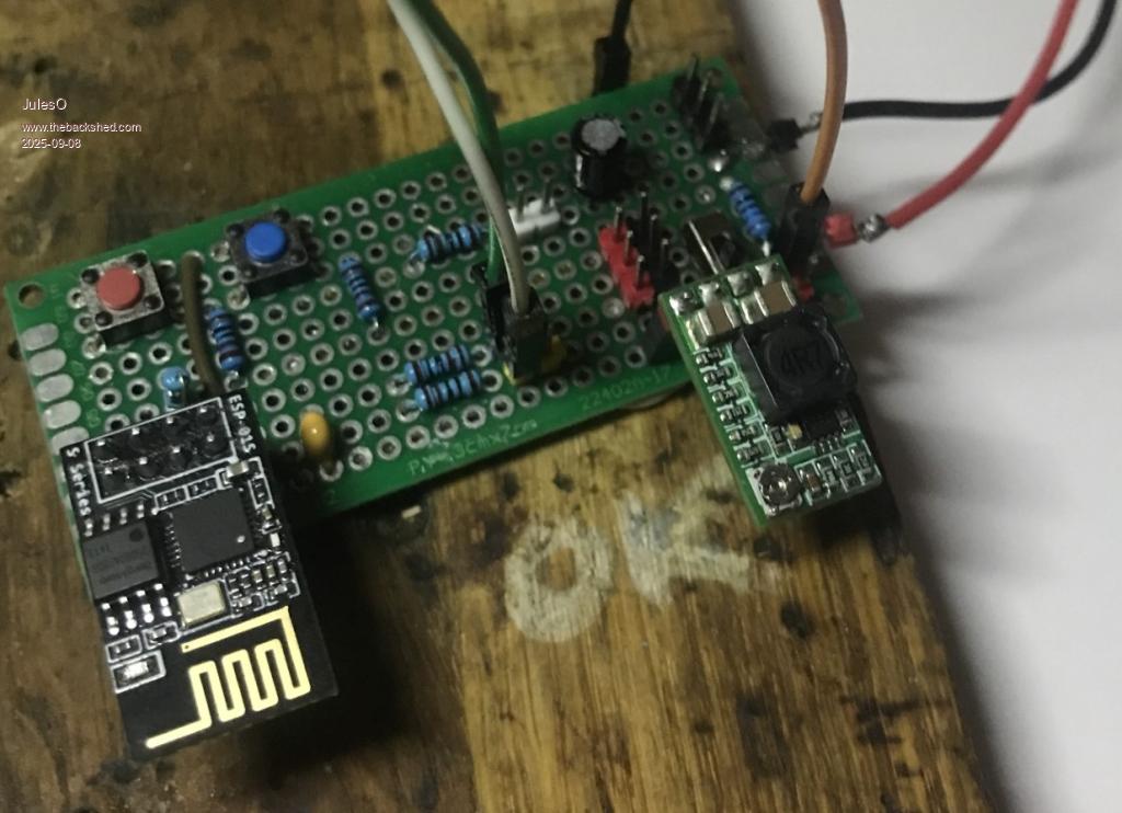

I’m reviving this post because I recently discovered ESPTerm and built one for myself. However, I can’t get it to work with my beloved PicoMite VGA! Is there a way to route the USB serial connection to one of the Pico’s serial ports?
That would be awesome for remote control of the PicoMite VGA! I’m currently trying to program a minimal VGA driver for the Milk-V Duo 64M, so I can then tinker with the processor’s RTOS core and—hopefully—encourage you guys (well, mostly the famous @Thwill) to port MMB4L to RISC-V! ;)
I needed a serial terminal to access U-Boot during the Milk-V Duo’s boot process, so I could load new programs onto the RTOS core. However, my attempts with MMBASIC were blocked by my inability to handle typical VT100 terminal sequences. I managed to get output from the Milk-V Duo and send characters to it, but I had no backspace, Ctrl+C, or F10 functionality... So I switched to ESPTerm.
I'm also develloping a text game adventure (with pictures and sounds!) for the picomite VGA that i'd like to show you once I'll finished the whole story ! It basically is a remake of the dracula's story where you, as a young clerk, go to Dracula's castle and have to kill him before the night rise.
Thanks again to Geoff and Pete and to everyone for your work, insights, and shared experiences!
