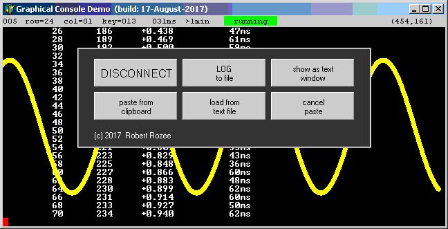

attached is a demo of a graphics terminal for the micromite i've been tinkering with for the past few weeks:
2017-08-17_123000_demo_17-aug.zip
this is essentially a VT220 terminal emulator with a glass graphics plane added over the front. the text and graphics are completely independent:
as this is just a demo, instructions are pretty scarce i'm afraid. upon running GFXterm.exe just right-click on the text area to bring up a panel of 6 control buttons - the top left one is 'CONNECT', which will get you started. the format of the connection string is:
PORTNAME:SPEED
so in my case i type in COM3:38400
two special key combinations are implemented:
alt-B sends a break to the serial port to reset an E-28 or similar
alt-C clears the graphics plane, you'll quickly find this useful!
there is a basic demo program included in the zip file that draws a sideways scrolling sinewave.

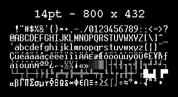

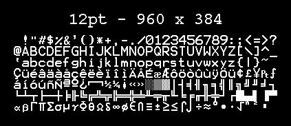

Posted: 04:12am 17 Aug 2017
have just done a bit of checking, and turns out i was quite wrong about having to stick to only 9 point. see the below screen grabs at 9, 12, and 14 points:
i'll work on making these three options selectable in some way.

  robert.rozee said   here's a new beta that allows for 3 possible font sizes: 9pt (default), 12p, and 14pt.
Different fonts working here on XP, definitely more readable. Not sure but have you got Alt-2/3 reversed?

alt-1/2/3 are in the correct order, it is just that the 12 point 'Terminal' font is narrower than the 14 point. the point size of a font refers purely to the character height, with the width largely up to the font designer.

another beta, this one is getting close to a finished product. the 'action button' panel has now been replaced with a more conventional right-click menu, with several of the alt-key functions moved there.
it is now possible to set the default foreground colour. this setting, along with font size and last successful comm port string are saved in the windows registry. there have also been numerous small bug fixes and enhancements made under the hood.
a Quickstart Guide has been added, detailing basic usage.
2017-09-07_234253_GFXterm_8-sep-2017.zip
to run GFXterm the only file you need is GFXterm.exe - this was one of the two main design goals, so it can be used without needing any installation (the other main design goal was making simple graphics available).
